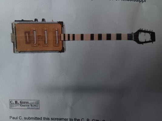

I originally said I saw a video on a converted Mustang guitar that turned out to be a 24" scale youth Strat.
Since the Tres Cubano works on a 19" scale, my mind was on the old Mustang/Duo-Sonic with the 22" scale.
The youth acoustic guitars can be found in the 19" scale but it seems that all youth electrics are now 24" scale and would require a custom made conversion neck.
