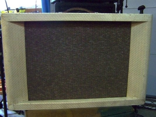

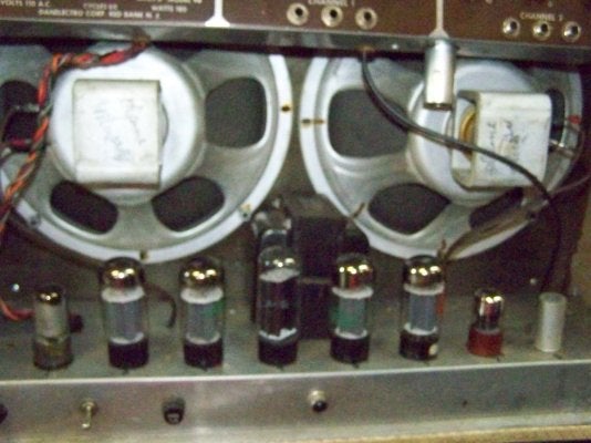

I've had a similar model, late 50's. Twin Twelve Series D model 94. Simple inside. Good amp. Not a strong amp if you compare with 2 x 6L6 Fender amps. They have some inherent dirt because Dano used smallish OT's.. The baffle board in these, and into the 60's, is very thin pressboard, like 3/16"! ....and not well fastened. Basically the speakers were holding the baffle flat rather than the baffle holding the speakers flat! :lol: I replaced mine with 1/2" plywood, it was a lot of work because the edges had to be beveled to fit the amp front/side contour. Part of the speaker hides behind those beveled sides.
Mine was a larger 2 x 12 version with original alnico speakers that were rebuilt long before I got the amp.

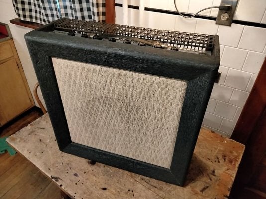

To me the superior sounding model Dano was a couple years later , from about 60-62. Dano Explorer with 6L6's. or Centurian in a 6V6 amp. Although very similar electronically.
Another Explorer I had top middle right and below it one I put into a tweed Bassman cab also:
