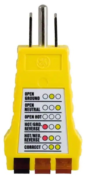

Keep one of these in your bag, and check every receptacle in the stage area. Unlike the LED type testers, these use neon lamps so they're extremely rugged and last many many years.
This is perhaps the cheapest (~$10) true life insurance you can buy. Two yellow lights means it's safe.
I've played places where I found miswired power boxes, and taped over 'em so nobody else plugs in there.
Good idea. I’ve been using a fork and a butter knife.

I too carry a circuit checker in my gear bag AND use it every time I plug in.
After Maria the venue where the open mic/jam I hosted had 3 circuits with an open ground. The owner had done some quick rewiring and never checked his work. Needless to say there was no open mic/jam that night. A real electrician was called in and a lot of electrical problems got fixed.
You never can be too careful around electricity.
