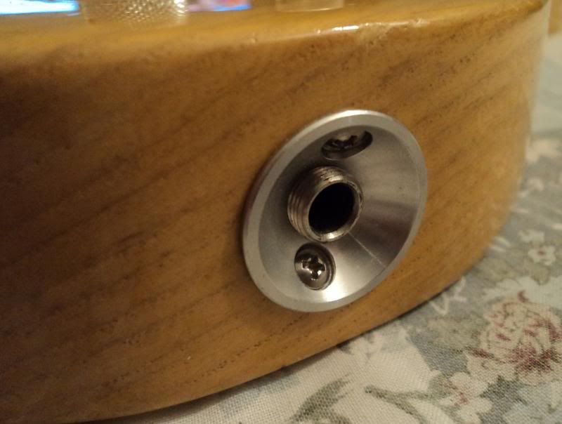

I've managed to find a few great right angled cables that fit my Teles only to discover they won't fit the build with the electrosocket. One of my Danocasters has a shallower jack cub and it'll accept any plug I throw at it.. all I need is a source for that besides the one Mark Rutter has which I'm sure is great but I've got more than a dozen Teles that I would like to convert.
I've found this annoying problem too, and usually manage to make it work by not using a washer between the jack and socket, and sometimes have to countersink the back of the electrosocket if the jack doesn't screw in all the way flush.

a longer switchcraft jack helps with right angles too. (like the one I pictured earlier)

its a really easy 'mod'
just drill (or start you dont actually have to drill)
2 holes to accept the screws the size of pickguard ones.
the bowl piece screws onto the switchcraft jack and then you screw that whole shebang down.
its reversible because once removed you cant see the drill holes which are covered by the milled cup. But once you go electro I doubt you'll go back.
its really an ingenius design im surprised Leo didnt think of it.
but Ill say this they can fail sort of, ive had one screw itself loose somehow. But all you have to do is take the screws out and screw it back on tight.
compared to the nightmare of getting a cup keeper back in its place the elcetro is well worth the $15 or whatever they cost.
the only tele I dont have one on is my 52RI which only failed once.
I use the 2 strikes rule: fail once I keep the original, fail twice the electro is going on. My 52RI cup only failed once in 7 years (knock wood)
but the main advantage is I can use right angles. Im so used to using those I get annoyed my 52RI has the trad cup (damn you Leo!) :rolleyes:
