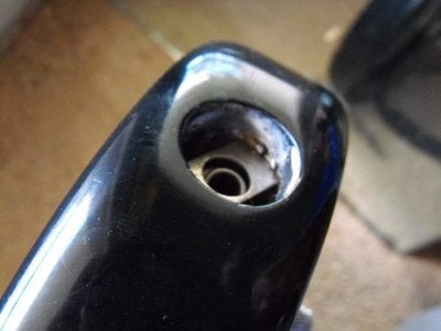

    Someone may have already mentioned a similar method but I searched and was unable to find it, if it exist.
    All you need is these three things.
    1. sharpened pencil.
    2. A 1/2 or 12 mm socket with a 1/2" drive.
    3. A pair of vice grips.
    First you want to secure the 1/2 or 2mm socket with your vice grips as high on the socket as possible so you don't scratch your tele. Remove vice grips from socket for now.
    Poke the sharp end of the pencil through the hole of the socket into the input jack. If the pencil has an eraser,you should remove it.
    Tap on the end of the pencil hard enough so that the wood of the pencil distorts and grabs onto the inside of the jack.
    Take your vice grips and secure them to the 1/2 or 12mm socket.
    Tighten the nut.
    By the way I know about the Electrosocket. This little trick is something I have done to many teles through the years.
    You can add fingernail polish or blue Locktite if you feel the need.
    Hope you guys find this helpful.

    Having a hard time understanding what your doing. A pic perhaps?

    I think I got it.You force the pencil into the 1/4" output jack ,slide the socket down over the pencil to the nut on the jack.Hold the pencil so the jack doesn't turn tighten nut.Sorta clever idea.You don't have to remove the control plate and hold the jack from spinning and breaking the wires.I think someone sell a tool that does the same thing for about $15 dollars.Pencil trick might be worth a try

    can't you hold the back of the jack from spinning through the control rout hole?.....

    You got it. You can use other items besides a pencil as long as that item fits through the socket. You might have to hold the pencil with another pair of pliers too if you cant get a good enough grip with your hand.

    Here's a quick fix if your jack holding plate is loose in the body slots.....
    I cut down a few sharp tack points and jammed them one on each corner of the side slots.. tapped them in with the edge of some pliers and a light hammer....
    worked a treat... jack is solid as a rock now...:cool:
