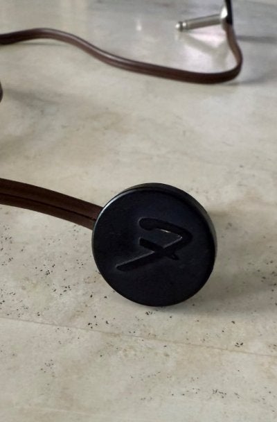

I was in a pinch a couple of years back & hard wired a speaker to my 6G2 combo amp. I used less than a foot of tv power cord because I didn't have any speaker cable. I soldered the wire to a Switchcraft 1/4" mono plug. It works fine, but i thought that perhaps I should reconsider??? 🤔
The speaker is a 12" Rola, 8 ohm.
Any ideas or suggestions would be greatly appreciated.
Yeah I did that all the time growing up and it worked fine. I'd use whatever wire, speakers, transformers, old amplifiers from radios, hi-fis and TVs, parts of old electric and electronic discards to patch together stuff that worked for my purposes. The electric wire you used is probably copper and greater in diameter to typical speaker wire, so you should be fine.
