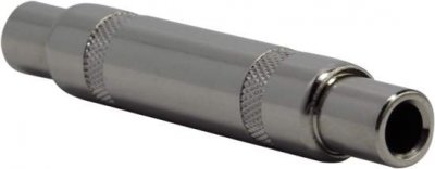

    I use a 1-12" combo amp as an extension cabinet all of the time. That way, I also have a spare amp if I need it. I'm not familiar with the back of the Vox AC15c1, but all I do is connect a speaker cable of whatever length I need (I like to space the two combos across the stage) from the "active" amp's extension speaker out jack to the male plug connected to the "spare" combo's speaker using a short two-female-adapter.
