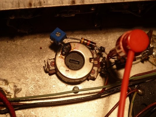

Here is a photo of how I added the bias adjustment trim pot to the existing bias balance pot on my Bandmaster Reverb. The wiper of the blue trim pot is connected to the 10K resistor, which is coming off of one of the outer legs of the balance pot. One of the outer legs of the trim pot is soldered to the balance pot, and the other outer leg of the trim pot is not connected to anything.

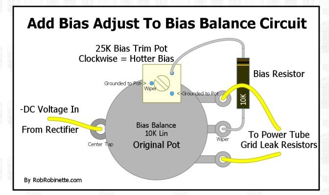

I found this diagram on Rob R's website and I think it matches up with my Vibrolux Reverb wiring. It looks like he is grounding both the wiper and one of the outer legs of the trim pot to the original balance pot, and connecting a 10K resistor from the wiper of the original pot to the other leg of the trim pot.

Robs method looks like a quick and simple mod that should work just fine, but I do appreciate the more elegant solutions that 2L man shows us in post #2.
Robs diagram states "-DC voltage in from rectifier", but I presume he means you to connect the middle tap to the opposing end of the 3k3 resistor that the rectifier is connected to.
Whether one connects the wiper of the trim-pot to the bias-resistor, or to the ground of the balance-pot case makes little to no difference, but it probably makes for a more stable construction if done as shown.

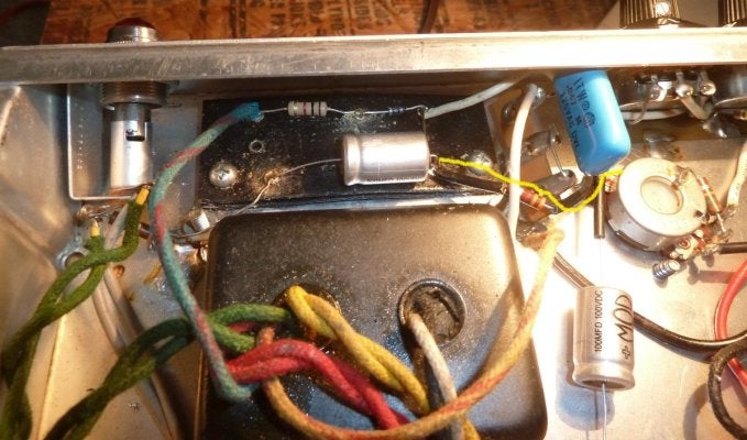

I think Rob means the negative DC voltage from the bias board is connected to the rear terminal on the balance pot. I have drawn a yellow line showing the connection to from the bias board, thru a 3.3K resistor to the rear terminal.
The terminal strip with the blue cap has nothing to do with the bias supply.
I haven't yet cleaned the flux from the bias board, so it looks pretty awful in this photo.
Basically, leave that connection as it is now.
Yes, will do. I have completed recapping the entire amp. I have the 10K trim pot for the adjustable bias, but don't have a 10K resistor on hand to replace the 15K currently on the bias adjustment pot. I'm currently biased at 14.6 and 14.43 Watts using Sovtek 5881 WXT power tubes, which is around 58%, so the bias trim pot will have to wait until I get to my local parts store.
