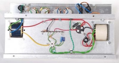

May 7, 2020
2
Raeren/Belgium
I'm not sure what the circuit is. My pic aren't hi-res enough to get component values
Hi Gus,
maybe you remember me from the Vintage Amps Forum where I did the VOX clones of AC4 to different AC30 ("Surrounded by clones ...") about 6 years ago. ;)
I caught some better pics a few years ago from their advertisment - maybe this could help:
A friend of mine bought one J.M.I/MG AC15 (which I already modded with an additional Top Boost Kit at the back) & one AC4, which will be modded too onto a EF86.
Don't look for a EF86 here like on the vintage AC4 because there isn't. Steve Giles used a ECC83 circuit instead (EF86 too sensitive?). But he did an exellent job on using the L-shape even for the AC4.

gusfinley
Jun 11, 2014
1,765
SLC, UT
Hi Gus,
View attachment 717136 View attachment 717137
@voskarp
Very nice job you did with your AC4!
Cheers
LuciMan! Welcome to the forum!
I don't remember you by name (if it is the same), but I do remember your "Surrounded by clones" Thread.
It was some serious eye candy!
While I don't sling a telecaster, the Shock Brothers Amp forum has a lot of great projects and some great expertise is shared.
You may recognize some other VAF members here or over at the Beat Gear Cavern ( more beatles related ) but this forum is more active in the D.I.Y area.
Thanks for the info on the JMI AC4. I've tried to steal whatever pics I can from the Internet Archive but it is tedious.
