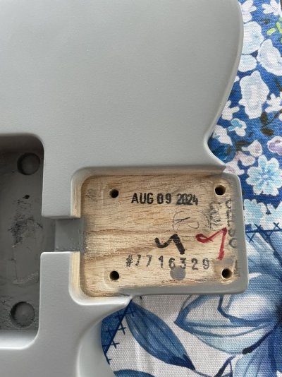

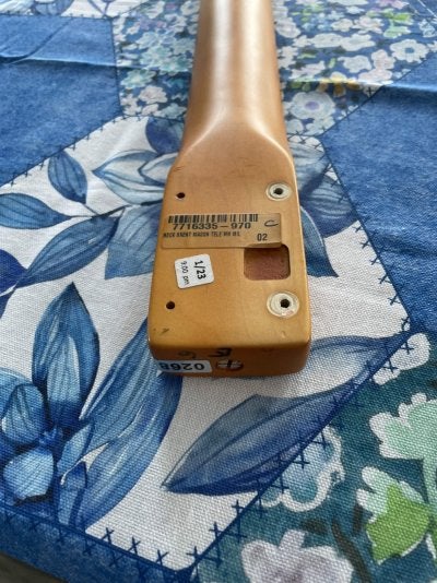

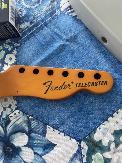

A little background: Last summer I bought a Warmoth neck with a 10"-16" compound radius. There is nothing wrong with the neck, but I just can't warm up to the compound radius. So I have been testing out all of my guitars with radii from 7.25" to 12". I don't have any trouble with any of these necks, but I discovered that I actually play the best on the 7.25" radius. So, I went shopping for a 7.25" neck, preferably from Fender, and I found a Brent Mason with a used stamp and the serial number partially scratched out. I have heard nothing but good things about this neck, so I bought it. Not leaving well enough alone, I found a Fender Brent Mason body, pristine, never having anything mounted on it. I found some used Sperzel locking tuners, and a couple of used pickups. So far I have $1,500 into this with about $900 left to go. $600 of that is the bender from Joe Glaser. And, finally, the neck sits too high in the pocket of the guitar body I originally wanted it for, and I don't want to shave the pocket down.
So, here's the dilemma. I am look at about $2,500 for a finished guitar, about the same price I can buy one used with a C.O.A. and a case. This is the only disadvantage I can see. Other than that, this guitar would have all Fender parts.
The advantages are:
1) I get my choice of pickups. I already have a Seymour Duncan Tele Hot Stack for the bridge--the stock pickup. I found an early version of the S.D. Strat Hot Stack, the one Brent Mason uses. At least that's what I have been led to believe. The neck position is up for grabs, but unless I can find a good deal on a used one, I will probably go with Sunday Handwound, a one man shop. I have a set of his Jazzmaster pickups and really like them.
2) I'll be using the new, and improved, wiring from Joe Glaser. Joe is the one who wired, and installed the bender, on Brent Mason's guitar. Joe prefers his new wiring system, and it only uses 2 knobs. Music City Bridge/Glaser Bender will be doing the bender install.
3) Joe recommends shorting out the bottom stack on the Strat pickup, using it as a pure single coil. The Hot Stacks are noiseless i.e. stacked humbuckers. I doubt I would do this mod on a "real" Fender.
4) Since the guitar will be visually altered anyway, I have contemplated other visual mods, like a chrome control plate, and a red pickguard to match the red cover on the middle pickup.
So, until I send the body to Nashville to have the bender installed, I can still abort this project, sell off the parts I have purchased, and recover most of my expenditure. I could save $600 plus shipping, and not install the bender, and make it into a kind of cool, but mostly standard guitar. The Brent Mason Telecaster is not a guitar I have lusted after, it's not beautiful to look at, not an oject d'arte. It's a tool, purpose built to be the swiss army knife of guitars, and I appreciate that.
The questions:
1) Am I dumb for doing this? (I think I already know the answer to this question.)
2) If one builds a guitar using all Fender parts, can it still be called a Fender? Was Clapton's Blackie a Fender or a partscaster?
3) What do you think about leaving out the bender? That would leave a hole next to the strap button, and it will cost more to install if I so decide later. The bender would probably just be a novelty to me, as I have never used one.
What do you think? By the way, this will be my third build, fourth if you count me gutting my Squier Jazzmaster 12 string and replacing almost everything. My avatar was my first build, and is still my favorite guitar.
BM whole.jpgneck pocket.jpgrouts.jpgneck heel.jpgFender headstock.jpgFender Telecaster.jpg

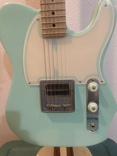

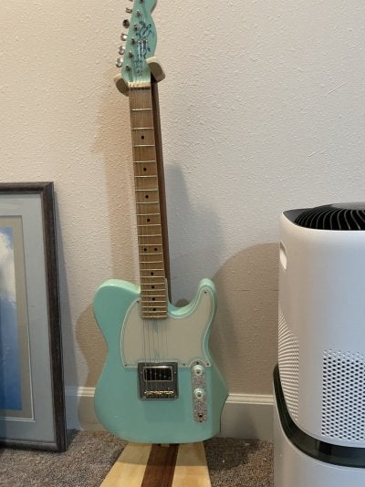

This is my second partscaster: Closeup with my first pickup try, a Lollar Charlie Christian.
This is the guitar with the neck I don't care for, my second build. I should see if the Fender neck fits on here. This one took some tweaking, three pickup changes, and different strings to make this sound the way I wanted. I had made plans to sand this down to a 9.5" radius. I still might do that. I think I have about $800 into this one. I bought the body, paulownia, from Guitar Fetish to learn how to paint.

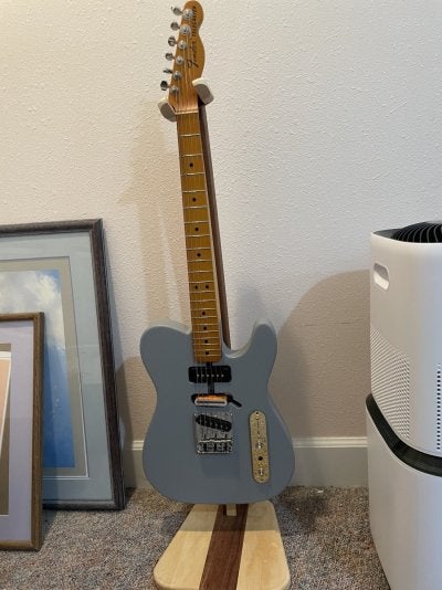

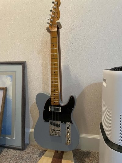

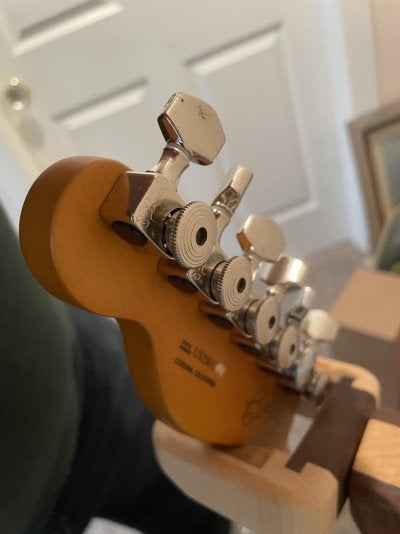

While not yet finished, the guitar is in it's final form, and it looks like this:
The control plate is from Philadelphia Luthier, and it has a modified volume control position so you can actually get your finger in there to switch out of the bridge position. I kept gold for the control knobs, and I kind of like it. The bridge is Kluson with brass saddles, and the neck pickup is a placeholder--a Guitar Madness Firebird that I got for $20 off ebay. My real neck pickup is probably 2 months away. Tuners, of course, are Sperzel locking. While the tuners are chrome, everything else is nickel. Strap buttons will be Dunlop, and are not installed yet. I'm still having issues with pickup volume balance, and while I thought the Firebird would fix it somewhat, it still overpowers the other two. It is 6.5k with alnico 5 bar magnets and my mini humbucker, coming from Sunday Handwound, is 6.7k with alnico 2 magnets. I'm hoping it's a bit tamer. So, what I have in essence, is a $3,200 Brent Mason, minus the case, bender, and C.O.A, for about $1,900 invested. I'm ok with that, and I love playing this thing, but it still hasn't surpassed my #1, which actually cost more.
