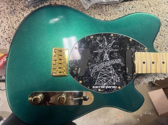

Does anyone make a Telecaster bridge with no pickup hole?
Do you mean one of those half-length things or do you mean an actual
full length ashtray bridge without the pickup hole?
If so, are you trying to make a reverse Esquire? (Only neck pickup)

Glendale has you covered. If you don’t like the price, just put a playing card underneath the pickup hole to cover it up. Ace of Spades.
https://glendaleguitars.com/plates/

The Tele std bridge plate creates a shorting loop around the pickup coil and changes the pickup's tone to this nasal Tele tone. The same/similar happens with the neck pickup's cover. It more or less depends on the plate's thickness and material (magnetic carbon steel, weak magnetic stainless steel, or someone non-magnetic - zinc or brass). Or cover's material (carbon steel, stainless steel, brass or German silver). In both cases, you can try to cut this loop somewhere (less visual place) and see what happens with the tone. In my opinion, it is unwanted weight on Tele body.
P.S. At once check the plate's contact with the body under the saddles. It can be lost, especially if the anchor screws are overtightened! I prefer to put additional small countersunk screws directly under the saddles. *Even more important for the kind of PB and JB basses :).

There are actually lots of them, but I'm assuming you don't want the plate part where the hole is? I don't know of any that are like a full Tele bridge with no pickup hole. If it's a matter of hiding the pickup routing, it wouldn't be hard to cover it with a thin piece of wood, or maybe pick guard material? I actually make my pickguards cover the routing, but DO cut the hole and mount the pickups IN the guard, but easier to NOT cut the hole!

What if you got a nickel baseplate and some short screws and screwed the baseplate up tight to the cover?

Seems like something any metalworker could fabricate pretty easily. Looks like there's places online that'll do it. Could probably give them a bridge plate and say "make this without the hole."

There are endless options if you don't want that empty hole staring at you, and if you prefer not to have that magnetic field on the strings near the bridge. You don't need to spend stupid money for a Glendale or similar bridge because those don't sound any better than cheaper ones.
One dead easy way would be to use double-stik tape to attach a small plate made of wood veneer or pickguard material over the bobbin hole and three screw holes. The plate can be a shape too--it doesn't have to be rectangular.
Maybe a playing card. I recommend either the ace of spades, or the joker.
