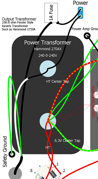

In response to interest expressed in another thread (about whose kit to buy) for a DIY Bill of Materials, I've put together something like that, and put the files into a folder on DropBox, so that it's easy to modify the materials and upload when people have pointed out all my errors and omissions:
There are 8 files in the folder:
1 | 5F2-A bill of materials.xlsx - my Excel spreadsheet containing items 2 and 4–6 below, plus a Calculators sheet I use occasionally
2 | General Notes 5F2-A BOM.pdf
3 | Fender 5F2-A layout marked up.pdf
4 | 5F2-A BOM.pdf
5 | Wire Gauges.pdf
6 | Hdw Info.pdf
7 | 5F2-A alt head schem.pdf
8 | 5F2-A alt head layout.pdf
The last two are my personal take on making changes to the layout (based largely on ideas from Merlin Blencowe, and adding features that may or may not be stupid/foolhardy ideas. They're included simply to provide some notions about where one might go, and the additional components are included and identified in both the XLS and PDF versions of the BOM.

Wha...wait... @chas.wahl up until now I was under the impression I was conversing with a real person. Please confirm you are not a robot by placing a check on every picture that contains a Telecaster.
Lowerleftcoast
Dec 30, 2019
7,460
california
Rob shows a different power cord wiring. Safety first. The hot wire should be the one that has a fuse and is switched. Yes the European standard of switching both hot and neutral wires can be implemented.

I ran across an error in the BOM I posted; can no longer edit first post, so here goes . . .
ERRATUM: what's listed as R5 (resistor 220k 1W) is described as V1b grid leak, when it's actually the grid leak for the 6V6 power tube! I've fixed that in the stuff uploaded to Dropbox.
