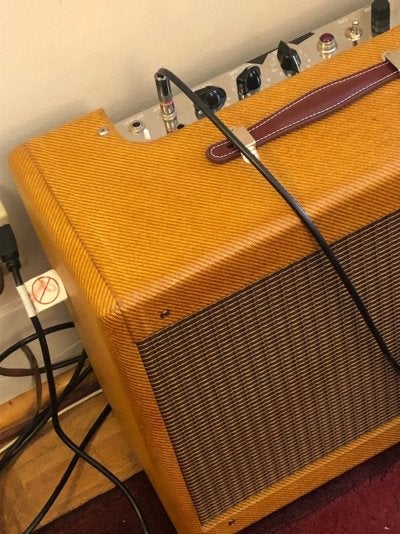

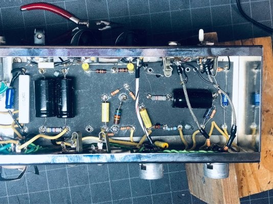

Built my first amp, naturally a 5E3. (Has everyone and their grandmother built a 5E3?) I used many of Gerald Weber's ideas. I'm attaching images of the Mojotone cabinet which I finished using 2 coats of amber shellac and then 4 coats of satin lacquer. The cabinet tone is a bit dark but is close in appearance to an original clean 1958 5E3 I have.
The amp tone is comporable to two 1958 5E3s I have though mine has almost no 60 cycle hum.
I started brushing the shellac but found applying with a clean towel better. For those that have done cabinets before:
- Is it better to apply a lacquer sealer coat first? I believe that would more easily even out the shellac. And I'm thinking the amber shellac may benefit, at least on the first coat, by going 50/50 with denatured alcohol.
- Did Fender just use spray on lacquer and the tone darkened over time? Or in the Tweed era did they darken with amber shellac or a toner in the lacquer

Interesting board layout, but I like it.
Shellac and lacquer love each other, makes no difference which order you apply them. But sooner or later you’ll develope your own method.
Mine: to seal the tweed I shoot the whole cab with Zinzer clear from a rattle can. Then I tint with a +\- 70/30 mix of clear to amber applied with a foam brush. Personally I like a slightly uneven look, so I go light and quickly with the tint. You can add more coats to darken the tone to your desired look. It’s hard to remove amber shellac if it goes on too thick/dark.
Once I’m happy with the tint I hit it with two coats of satin lacquer. Works for me. Call it my “nicotine tweed” finish”.

rschiller
Feb 9, 2016
214
Oakland, CA
I can't answer your questions as I'm not versed in this at all. However, I can share my own experience with Zinsser Bullseye clear shellack. I have a Fender Deluxe that I decided to add a couple of coats to as I noticed that the tweed seemed to be getting a bit too aged looking for a three year old amp, and I don't gig wth it. I cleaned it up first and then used a brush and applied three coats on top of what ever Fender had on there, and from your photos, mine looks like a clone of yours. I'm very happy with the colour, and finish.
I've read that a lacquer sealer coat makes applying the shellack a lot easier as the bare tweed really soaks up a lot of shellack. As a new Deluxe comes with at least one coat of something on it (presumably shellack as well), applying additional coats was a breeze.
I'm curious to know how the schematic of it differs from a stock Deluxe such that your's has no 60 cycle hum?? That would be worth doing - proving doing so didn't alter the tone in any other way.
If you look at the image of my circuit board, you'll notice its quite a bit different than the standard 5E3 layout. There are a lot of tweaks and circuit changes that keep the grid leads essentially as short as if wired P-to-P. A careful ground scheme is needed as are careful filament wndings. A lot of good information on that from Valve Wizard online material.
While in the 50s Fender use DC filimanet windings, which are quieter than the AC windings we use today, other aspects of Fender's ground scheme can be improved on. But in no way am I saying or implying that Leo Fender didn't create many masterpieces.
Really? I only have seen 50s Tweed amps where one tap of the heater lead of the PT is directly connected to ground (and also one lug of the heater connection of the tube sockets to ground) and the other tap is runnign as single wire to the sockets' lugs. It's still AC.
  • Like
Reactions: NTC
NTC
2,399
Agreed. There is no rectifier for the filament power - it comes straight from the transformer.

Thank you! Fender's "old way" of filaments did have an advantage of useing 12v DC rather than 6.3v AC; the DC is quieter. Certainly the original Fender ground scheme can be improved.
Yep I"m wrong. Single ended AC.
Fender's old way used 6VAC from the first amps in 1946 right up to today.
