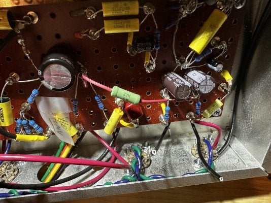

mountainhick
May 2, 2021
1,878
Rocky Mountains
You do not gain anything by grounding the bridge negative to the chassis at the rectifier. Better for that point to be connected to a ground bus that connects to chassis all the way at the other end, meaning at the input jack. All other negative nodes for each stage of voltage dropping should be connected to this bus.
I am happy to sketch this for you, but can't find any schematic for your project posted to this thread. Not going to engage in confusing word salad.
If what you are doing is close to Crowe Baah, and my GA5-T-with reverb projects, we can certainly walk you through the options, details.
Are you building a board, doing point to point? what's the plan?
Do you already have the filter caps? If you are using tag strips, radials are cheaper and many are really high quality if you get nichicon, panasonic etc. Some rated for 10,000 hours

Crowe Baaah
Gold Supporter
Aug 11, 2024
562
44
PA
I’d be interested in seeing a schematic, too.
I fit an (almost) entire PS between to five lug terminals, and found the radials to be quite helpful to keep things compact. I put the first filter in the middle of the full-wave bridge rectifier (note: I was meticulous with shrink wrap and ensuring space between leads and components—you don’t want to short something).
Not the only way to skin a cat, but one way to, as an example:

ievans
Jul 8, 2009
379
50
Sucka Free, CA
I like mounting radial caps horizontally across the terminal strips (and used some silicone to stabilize them). Each pair shares a ground lug, and the ground is isolated so I can tie it to a single point of my choosing.
