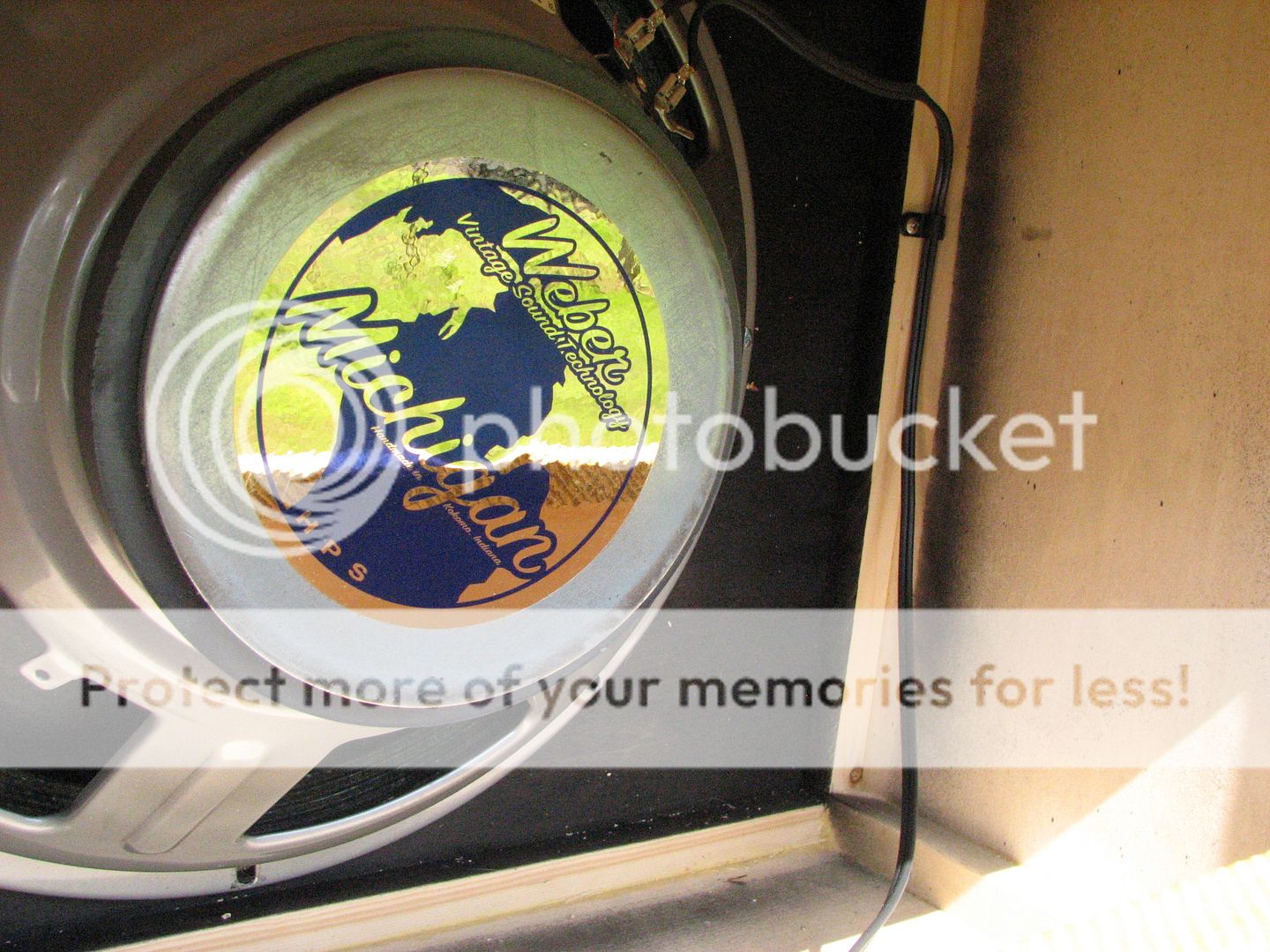

A few years back after I got a Bassman head, did a recap and a few mods to it I was inquiring about a speaker on the vintage amp board. Mostly what was mentioned was a Weber Califonia or Michigan.
At the time I wound up going with a 2-10 Ragin Cagin set up.
Then I started reading all these 15" speaker threads here a couple years ago.
I was watching ebay for a while & came across this 4ohm speaker for a resonable bid and after playin it for a while decided it will be with me for as long as I have this amp.
