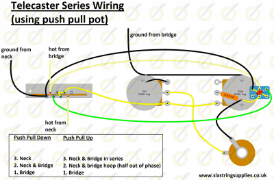

    Hey there, I’m pretty new here, and have been searching here for hours now but getting more and more confused
    i bought myself a Chinese telecaster knock- off (amazing action btw) and wanted to use the opportunity to do some writing experimentation.
    I can silver but wiring schematics go over my head
    i would like to know where I can find a wiring diagram for the following scenario:
    pulling the push/ pull knob, I’d get the option of having both of my single coils in middle position in series, for that hummbucker- like effect
    also, what other additional options would I be able to achieve with that one push/pull configuration?

    Here's one way- Series-cudos to Deaf Eddie:
    SPUDCASTER, Billy3 and HeiA like this.

    Wow that was fast- thank you so much!!! Would I still be able to do a grease bucket modification to it? I’m pretty new on how to develop those kinda diagrams on my own

    FWIW, series won't be "humbucker effect" unless your pickups are wound and magnetized in the orientation that does that. You'd need to test to figure that out. But it will give you a different sound no matter what. So go for it.
    I would also add a push-pull on the volume control too and change the phase of the bridge pickup. That way you get the in or out of phase sounds which are sort of like a Strat between positions. Scroll this page down to where it says "Phase Reversal Switch". You just take the two wires from the bridge pickup and send them to the additional DPDT as shown, solder on the cross wires on the switch, and run the two "output" leads as before (above, bridge). http://www.1728.org/guitar.htm

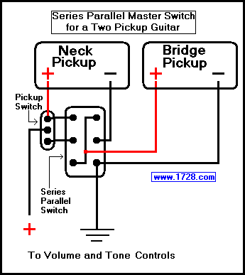

    Oh yeah that polarity thing has to be checked with a compass, right? There is a special tool for that, with that black or white flipping tube thingy, but a compass will do hahaha
  6. HeiA
    HeiA TDPRI Member
    31
    11
    Jan 18, 2021
    Germany
    Like this?

    That's the series / parallel mod. That's already in the diagram above. The phase switch only has to deal with one pickup (you flip the wiring on one and then they are out-of-phase with each other).

    I came across this schematic
    https://www.sixstringsupplies.co.uk/telecaster-wiring-in-series
    which is kinda intriguing, although I’m not sure what half out of Phase actually would sound like, or what the benefits would be- curious to see what you guys have to say about that

    For the series sound, a push-pull pot works fine, but a 4-way switch is much more convenient in my opinion. (I'm also constantly adjusting volume and tone, or doing volume swells, so I don't like push-pulls).
    For the noise cancelling effect ('humbucking') I wouldn't worry too much about finding a compass. Just turn up your amp and listen to the amount of hum in each position; if the middle position is quieter, that means it's already noise cancelling. If it isn't noise cancelling, it's not the end of the world either.
