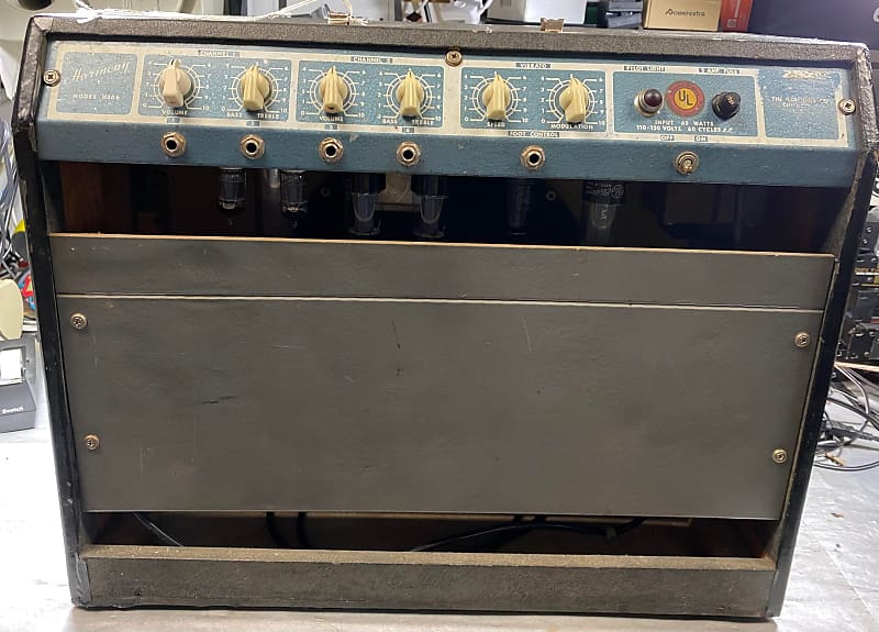

A few differences?
img_20200422_093027258-jpg.709892
"Each channel has its own volume control, and there is a single tone control. The tone control was set up in such a way as to blend a treble bypass cap and a treble cut cap which are both connected to the volume control as well. This means that as you turn the volume down, the treble cut cap rolls off the treble at lower frequencies while the treble also increasingly ignores the volume control via the bypass cap."
Uh, not according to the schematic. The volume controls are used as a resistive divider, the same as how most reasonable people use them, not with the signal entering the wiper. The tone control is just a treble roll off, no bypass capacitor to shunt treble around the volume controls. The phase inverter is a Paraphase rather than a Cathodyne which the Deluxe uses. So you do not get the volume interactivity and no treble boost from the tone control. That being said, I think the Paraphase PI is better sounding than the Cathodyne when running into distortion, I have not been convinced yet on the value of the volume pots used backwards as in the Deluxe. Adding one capacitor to the tone control and I think it might even be a more friendly amp than the 5E3.
