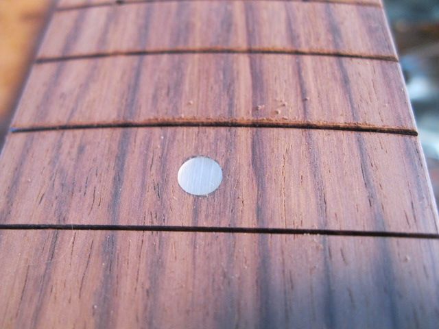

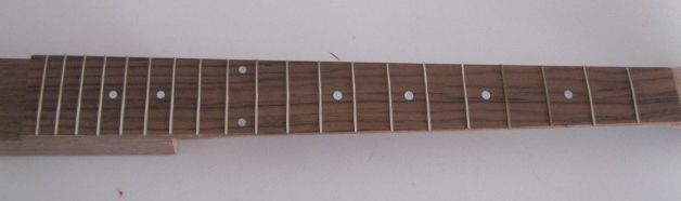

I sanded the fretboard lightly with my radius beam at 220 grit and used a small triangular file to chamfer the slots. I only like to do it for 2 strokes each slot. Reason... the fretwire is extruded and where the bead meets the tang produces a fillet ( fill - it.....not filet...that's a steak ) or small radius between the surfaces. The chamfer allows the fret to seat more easily. It's worth the effort in my opinion.
My first and best fretwire radius jig
The frets get pressed in. 12-14 were harder than usual due to the heel.
I press and trim off the ends on one side to keep the fret from popping out during that task.
and they are in and trimmed flush.
