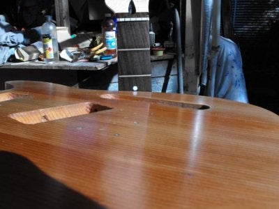

  11. trev333
    trev333 Doctor of Teleocity Ad Free Member
    Danish Oil, hand rubbed over Oregon Pine... comes up Ok.. and it's easy to work with... I use my bare hands usually to apply it..., cleans up with turps... build up as many layers as you want over time...
    I use it on necks as well, it gets harder and shinier with use, not sticky, no drag........:)
