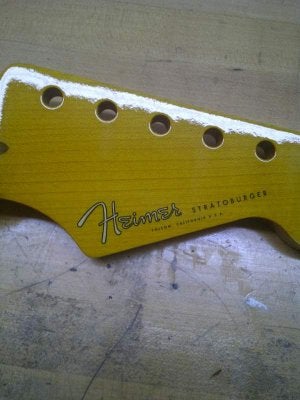

    Thought I would share a thinning formula for spraying Watco brushing lacquer.
    50% Acetone
    33% Watco
    17% Lacquer thinner.
    This formula lays the material down beautifully and level, and passes the fingernail test in a week or so.

    I just can't get my mind around any water based finish. Probably cause I'm old and reticent to change.
    I wear a respirator so I'm less concerned about the VOC.
    I'm sure our government will see to it that we use WB finishes at some point, but until that time, I'll be throwing the VOC around as I know how to control it and I like the end result!
    I use water sparingly as a tool with wood. I raise the grain for final sand outs, pop up the router bit tear outs on end grain to sand out etc. But water and furniture grade wood in my mind are a bad combination. I know at some point I'll be forced to use WB finishes, as that will be the only finish we can buy, but until that time...I'll be throwing out a few oz's of VOC's in my touch up gun.
    Here's a pic of the 6th and final coat that I applied on a headtsock to bury JBennetts decal prior to wet sanding it down. It's nearly as smooth as a baby's bottom without the wet sand. I'm guessing this finish would take me a long time to master with WB to learn how to apply it properly.
    I'm just delaying the inevitable I guess...
