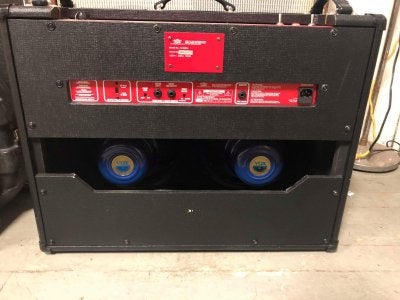

    Anyone use the ac30 normal channel?
    How do you like it/ use it?
    I have a limited edition hw ac30 with only the normal channel. What’s the best way to get some treble in on it?

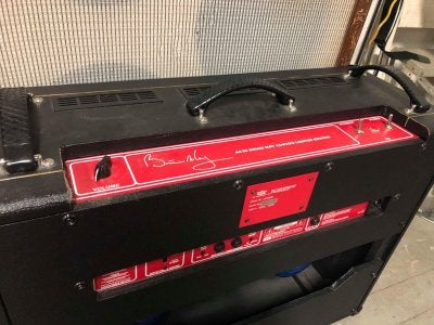

    Ac30bm. One knob hand wired. One Input on the back. It sounds so good with the blues but just looking for some more top end.
    One of my friends said to try a jhs colour box to eq it better

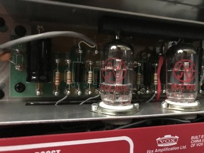

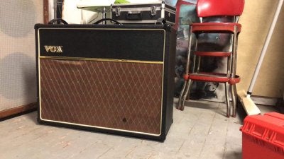

    Thanks for posting pics, jc4yr. Very nice amp !
    One big advantage of the hand-wired AC's is it's easy to mod them, and minor mods like caps, etc are reversable.
    Does it get brighter the louder it is ? In which case you could use an attenuator to manage the volume.... I've never played the BM Model (I have the AC30 HWH). The blue speakers should be a bit brighter than greenbacks.
    Maybe an EQ pedal in front of the input ?

    Many thanks! The board is super small and clean. Ya know that’s a really good point. I should try it louder and see how it changes.
    If not then eq. I have a really educated tech that could mod it.

    Haha, I meant MY "one volume, one tone" layout. Yours has only a volume control. And that's ok, but there's not a lot of tone shaping options on board there.. Usually I'd say: brighter speakers, but those Blues should be plenty bright already. I'd try an EQ pedal next. Find a setting where you get more trebles present, but no extra volume when you switch the EQ pedal on. You don't want to introduce hiss in you sound, which can come with added treble. So reduce some mids, add a hair of highs and leave the bass alone. That would be my approach...
