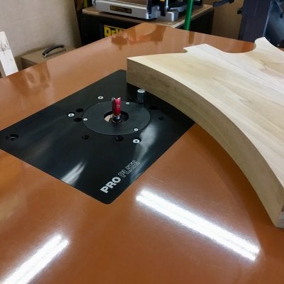

  16. MM73
    MM73 Tele-Afflicted
    45
    Feb 24, 2015
    South Lyon, MI
    Well, in browsing router threads, I found the one I started.
    I’ll just finish my router table here, and save my jointer thread for actual jointer discussion.
    I finally had one more occasion where I needed to drill straight holes further into a piece than my drill press can reach.
    So I bought one of those doo-hickeys that converts your hand held drill into a mini press.
    It worked great.
    Just need to cut the rabbet, and then I can start using this table.
    I’ll noodle on fences and locating a miter slot.

  20. MM73
    MM73 Tele-Afflicted
    45
    Feb 24, 2015
    South Lyon, MI
    I was kinda banned...then I think everyone forgot about it.
    A router table isn’t shaped like a guitar, so it flew under the radar till it was too late!
    Got my Detroit ride in this morning, then had some time in the shop : )
    Scott Fountain on Belle Island.
    Magnum, Axel, and Robocop together like they should be.
    Setup was good, but execution was rather poor - glad I picked up a leveling kit.
    “Finished” table thanks to donor hardware from the scrap table.
    Miter slot and fence will come later.
    Now where did I put the Tigre?
    Flat enough for me :)
