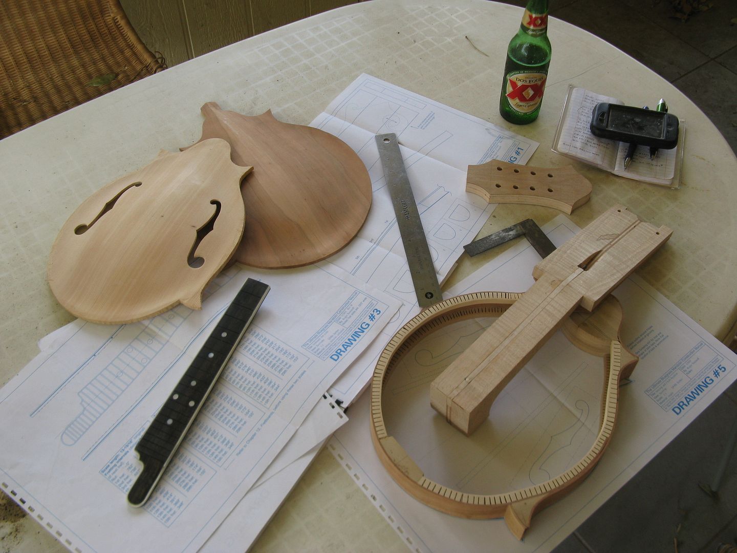

    Let’s start with this pile of……………parts. If you didn’t go back to review the original thread, I don’t blame you. To save you some time I’ll just tell you I started a Mesquite F type and a Cherry A type. This is the Cherry A type. The parts have been stabilizing for about 4 years, so I shouldn’t have too much trouble with the wood moving
    Looks like a 6 year old tried to put a kit together, but I think we can work with that.
    Here’s the neck. The reason the whole thing went South. I think I have a plan using the connectors in the little bag.

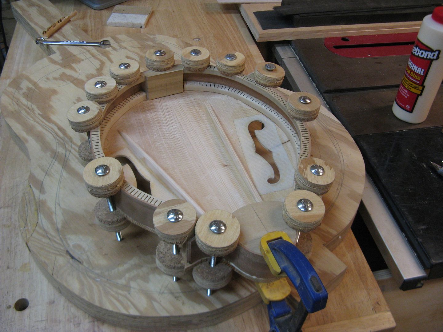

    The top was ready for attachment to the rim after some shaping of the tone bars so I busted out some clamps.

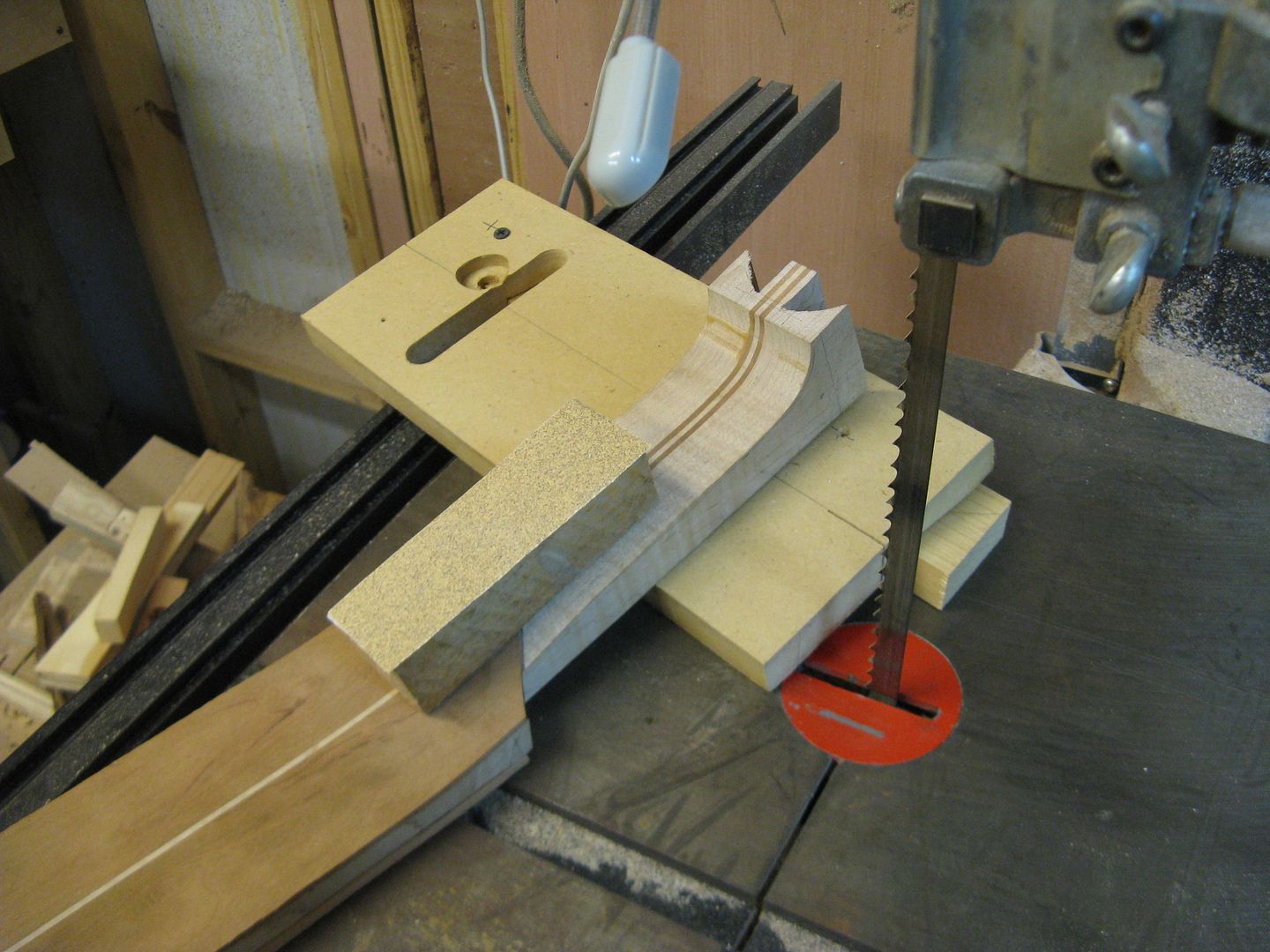

    Now I need to cut the taper of the heel to make it a little easier to see the joint.
    I cut one side from this end of the jig, then, flip the jig around and cut the other side from the other end. Used a block with 2-sided tape on one side & sandpaper on the other to raise the neck. Held the neck in place on the jig with my vise-like fingers.

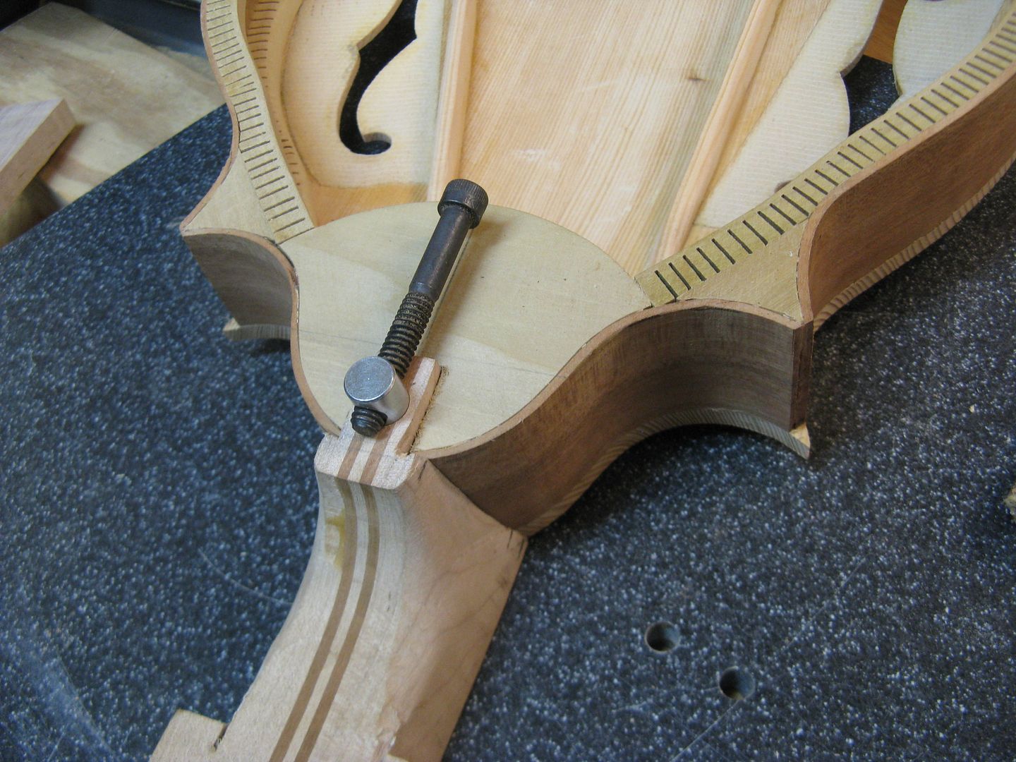

    Now for the mechanical attachment stuff. Drill a hole in the bottom of the tenon…
    …for the cross dowel. (Thanks jamorudd & Marty).
    Of course it will go deeper in the heel. Just use this little wrench to tighten it.

    The reason I left the 3 pieces of binding loose, and glued them as I went was because when I tried them together, the thin pieces would break or wrinkle when I tried to bend them. Also, the thin pieces are so thin, the acetone starts to melt them pretty quickly. I figured if I just hit them with the acetone once, I’d have a better chance of keeping the thin white line.
    All bound up and resting comfortably
