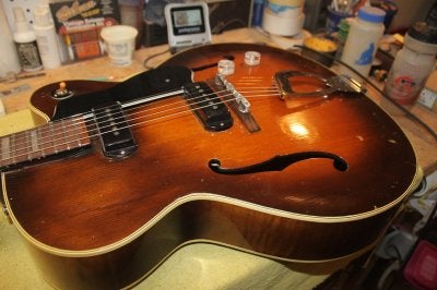

    My sense is your pickups might be too low if you just remove material from the middle part of the covers as shown in the technique above. I have an Epiphone Riviera with three Dog Ears and each one's cover sits on little bases that are curved on the bottom where they meet the guitar top. But they are very narrow covers also. If you have very deep covers you might not need any such thing.

    The bases are actually spacers used to adjust the height, and more importantly the angle, of the pickups beyond what you'd want to do with the ajustable polepieces. I've made them out of scraps of pickguard material and yes, it's best to shape the bottoms to fit the curve of the top but ES guitars don't always have as much of a dramatic belly as a LP (maybe because the curves aren't as abrupt they're spread out over a larger body... hmm I may have stumbled upon a lyric there...)

    A wood spacer carved to fit the body. My avatar guitar had one from the factory for the original large single coil pickups.
