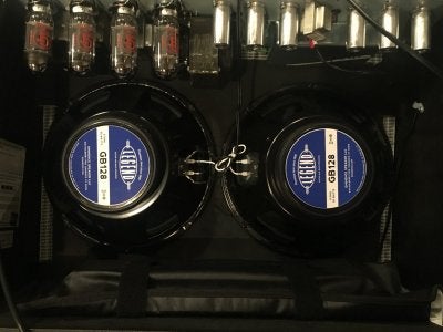

    Eminence GB128 (50W):
    These were the only non-Celestion speakers that I had, and not surprisingly they sounded very different from the rest. They are billed as being British-sounding, and I wouldn't disagree. They're kind of like a Celestion G12M greenback "imposter"... they sound similar, but also not similar. I would love these in a closed back 4x12 with a nice Marshall head to go with it, but in a Fender Twin they are not my first choice because I'm looking for a more even tonal response. These are priced aggressively, and as such I would choose these in a heartbeat over a set of Celestion greenbacks which are 3X the price. 9/10.

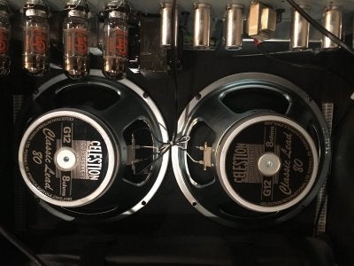

    Celestion Classic Lead 80 (80W):
    Based on looks I expected it to be the best of the bunch. The 50 oz. magnet and metal housing on it are both massive. It had a typical Celestion neutral tone, and the cleans sounded fantastic. When I added dirt I found it broke up easily with the mids getting too muddy for my taste. Note recognition was less discernible to me than with other speakers when playing chords with distortion. It's a good speaker but not what I'm after when I want overdrive. 8/10
