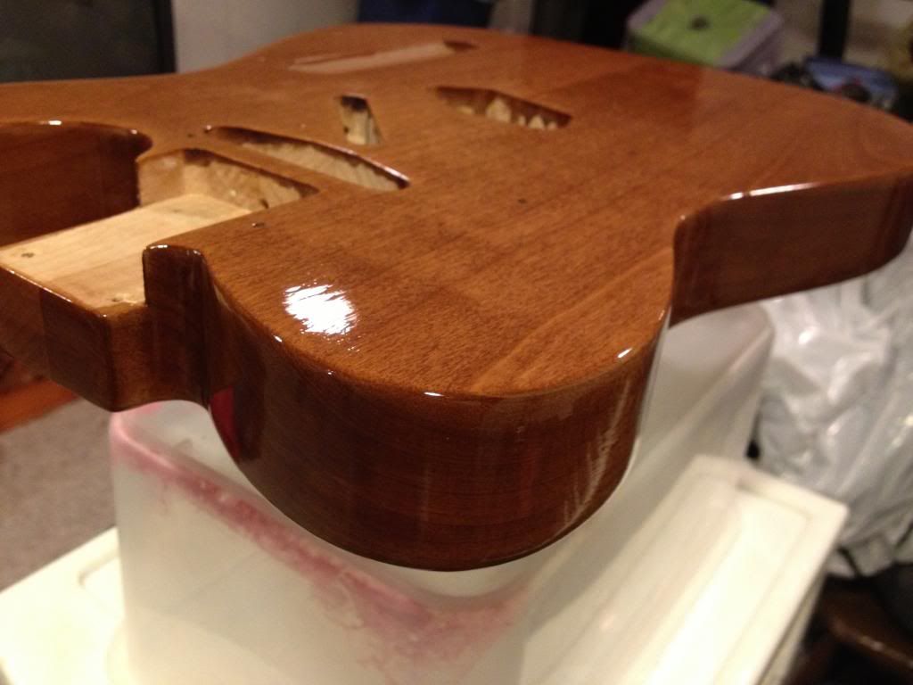

  18. Tele130
    Tele130 TDPRI Member
    62
    Mar 11, 2013
    Milwaukee
    OK, I've read this thread and I'm questioning where to go from here.:confused: This is my Ash body with a final coat of Tru-Oil......it's dry in the pic's. It has some very small bumps in it (dust?). I purchased the 4 different polishing componds from StewMac. I was going to wet sand with 2000 grit paper and the polish.
    Right now I'm letting it dry-cure for a week before I go any further.. Any suggestions? Oh yea, this is my very first build/finishing job.
    Thanks guys:D
  19. blimpo
    blimpo Tele-Meister
    492
    Mar 29, 2009
    southern indiana
    I see nothing wrong with that. It looks great.
