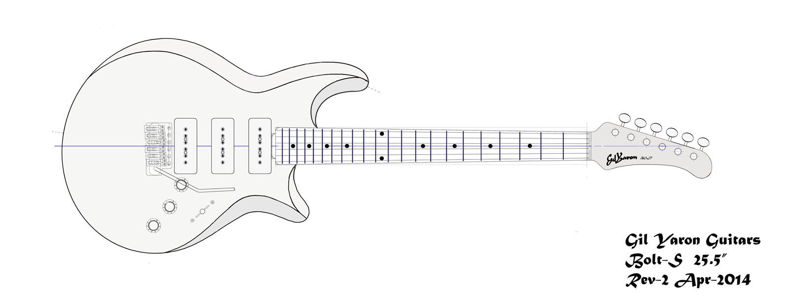

    The new design is called Bolt and is based on the F standard of 25 1/5" scale bolt-on neck with flat angle and a tremolo.
    The Bolt family will include at least two instruments, a Bolt-S (Strat type) and a Bolt-T (Tele style).
    I will start with the Bolt-S in this thread.
    Here's a couple of blueprints to show the general initial design ideas and aesthetics:
    I will explain every aspect of the design as I get to it during this proto build but in a few words.. the idea is to build an S type guitar in featherweight, with old 50's style neck shape as default, better truss-rod system and a wide array of PU options that are all based on my new patented AirGap design. This combination of extremely resonant lumber with the AirGap PU's is the heart of the Bolt. In addition it will have a tremolo (which is not yet determined) and optional body wood types and optional BRRW fingerboard.

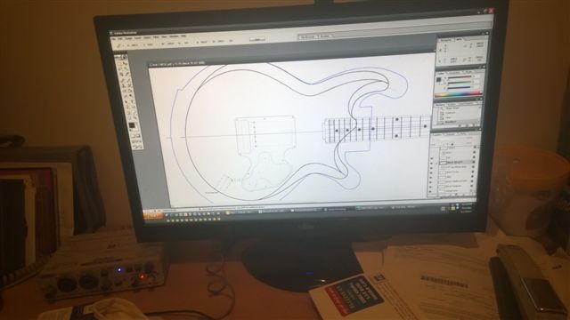

    Like always.. we start with the body and print two templates for it at this stage, one for the outline and the second for the curved bevel cuts.
    here's the outline template
    cut
    and smoothed
    and the Bevel template
    Here's both one on top of the other
