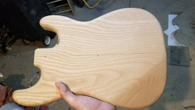

    I started a new hardtail start tonight!
    It will be a 25.5" scale (obviously) with a top loading hardtail bridge. I'll toss 22 tall narrow frets on this beast, and the neck will mirror my Tele build's - flame maple, though this time with a maple board and I'll leave it unstained.
    I haven't decided on pickups or electronics yet - I may go HSH, or I may go HSS. Probably the latter.
    Here's progress thus far:
    This will be the first of a pair, the second being a fretless p-bass for my dad.

    I'm thinking purely natural, black pickguard.
    My dad had a fretless pbass in the 70s, and had to sell it due to being a poor college student. This will match the one he let get away :)
    Roundover started:

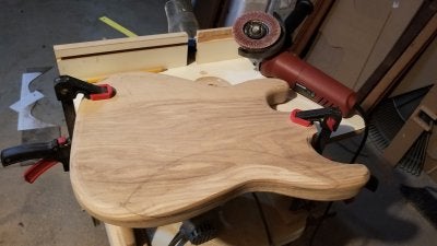

    Worked on the contours. I think a spindle sander is in my near future.
    20190418_232950.jpg 20190418_234448.jpg 20190418_235651.jpg 20190418_235632.jpg

    Also rounded over said contour edges, per Ron Kirns's tutorial.
    20190419_000936.jpg 20190419_002240.jpg 20190419_002228.jpg 20190419_002302.jpg 20190419_002251.jpg

    I couldn't be more pleased with the way the grain pokes through the arm contour!
