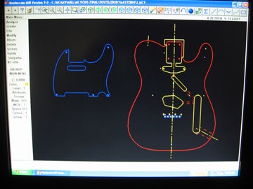

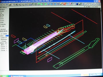

    OK! Here's the 53 replica CNC build that I was talking about in other posts. I finally got my pictures together to start posting. I've built 9 teles so far using allparts necks and purchased pickups. I've built the bodies and pickguards myself on a webb CNC. This is my first build were I'm manufacturing ALL parts from scratch. Neck, truss rod, Body, Bakelite pickguard, and pickups. All parts will be as close to a 53 as I can get. Nail holes in the body, pin router templet dowel plugs in body and templet screw holes in the neck. I drew all cad drawings and solid models for the neck and body myself using a 66' body and a friends neck. I should have used one of my necks because the "friends" tuner holes were abit out of spec!! All is now corrected. Let the fun begin!
    Lets start with the cad drawings of the body
    The classic 53 routes are there. Flattend control cavity, No flat on body input(output?) ,nail holes on front, dowel plugs on back.
    Next, the neck (correct one!)

    Mastercam 9? Hurco CNC?
    Are those the drawings from the .PDF manuals on the Fender site? I only ask because that scratchplate drawing isn't entirely accurate.
    I have an accurate drawing. I was about to ask if you wanted it but it looks like it's too late!

    ReVintage... The pickguard drawing was CMMed from a Warmoth guard that was on the 66'. Those pics were 3 weeks old and since then I've altered the lower lefthand outer radius to much less. More to what is seen in Nachos book. Which by the way I,ve used a HECK of alot in designing the body. Thanks Nacho!! If you have a drawing of a 50's guard I would love it! It's never too late!Thank you! You sound like you know what I,m working with. If you ,or anyone else would like the drawings I did in DXF,DWG,Mastercam or Solidworks, PM me and I,ll send them off!
    I cut the back half of the neck lastnight. Those pics will be posted tonight when I get home from work.
