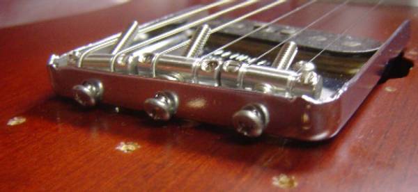

'05 CII Sq Std Tele Special - bubba mod take 2
Poster: yegbert  (see this users gallery)
Bridge plate is the ubiquitous $8.99 FENDER PAT PEND from MF. Saddles are Fender grooved stainless steel, the type that come on an MIM Classic Series '69 Thinline. Original bridge pickup was a humbucker. The body rout for the humbucker is closer to the neck than a traditional Tele single coil. The STB holes are rather large (string ferrule size) and are closer to the neck than per the vintage spec bridge. The MIM Standard bridge's STB hole are aligned with the stock Squier Tele Special's STB holes.
