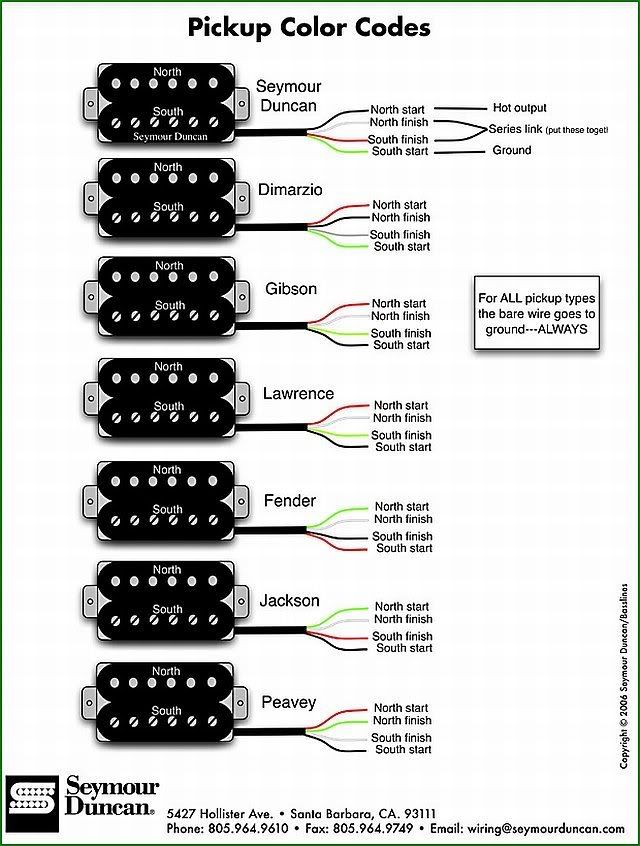

I'm really having a problem with finding a good guitar tech.I purchased a new wiring harness with the 4 way switch mod but the problem being is there is a humbucker in the neck.I think this really baffled the guy.I'm apparently ignorant and not sure this application is feasible with this neck pickup.It is noisy as hell which sounds like a ground issue.The bottom line is the guitar sounds like crap and this guitar has become a money pit.This is the second wire job from the ground up and this 4 way mod sounds like crap.I'm ready to give up and sell this albatros off cause down here in tampa florida there seems to be a shortage of competant techs.I need help with a wiring diagram with a humbucker on the neck and the 4 way switch mod.I gotta do this myself because I can't afford to keep paying clowns to f up my main guitar,

This shouldn't be a problem. Here's the 4-way switch wiring diagram.
A humbucker has 5 wires ..........two from each coil and a bare wire. In the case of a Seymour Duncan the red and white wires are spliced together and taped. Now you have three wires. The bare wire goes to ground. Treat the last two wires as the diagram above shows.
The picture below is a composite of the diagram above and the one Mark linked to. Click the bar to enlarge it. Hmmm.......... looks like an error on the diagram on the right. That is clearly not a 3-way switch. Note the similarities on how the pickups are wired.
Humbucker wiring color codes will vary with brand. See the Seymour Duncan diagram below.

A humbucker isn’t all that complicated, basically all it is, is two single coils side by side or stacked on top of each other.
Each single coil will have 2 wire coming out of it. One is where the coil winding was started, or the “start”, and the other where it was completed, or the “finish”.
On 4 wire humbuckers there will usually be a 5th, bare, which is soldered to the pickup case, or frame. It should always be connected to ground.
On the single lead humbuckers, there is a shielded lead from the pup. In those the two coils each have one of the 2 leads either the start or finish (depending on what ya wanna do) connected and the remaining lead form each become either the “hot” or + or the Ground or – or shield, it will be connected to the pickup frame.
