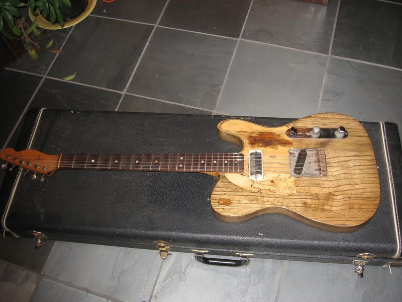

Update
Well you move two steps forward and one step back.
I replaced the humbucker and pickguard and cleaned it up a bit to see how it would look. When I tried to straighten the tuner it snapped into.
That's all I can do for now. Here are the latest pictures.
I replaced the humbucker and pickguard and cleaned it up a bit to see how it would look. When I tried to straighten the tuner it snapped in two.
L_N_A
Fixed!
You could always move the guts from the low E string tuner into the busted one, replace the humbucker, and do a Keith Richards tribute.
Well Good News and some bad news.
It's a 1966 Tele
It looks like someone tried to refinish a Blond body. It does look like the neck and the body belong together based on the old paint residue inside the neck pocket.
Now the bad news is some cretin butchered the neck pocket when they added the humbucker. I'm pretty sure this is a hanging offense here in Texas, at least it should be.
The control plate is really a mess.
I think the body was stripped completely and then sanded with coarse sand paper and a wipe on or spray on finish was applied. The electrical mastery on this guitar matches the woodworking skills.
So. If this was your guitar, what approach would you take to make it a player?
BTW, I do want to fix it up and keep it. It has a ton of redeeming features.

Heya L_N_A,
congrats on a great score!
For a '66 I'm kinda surprised the string ferrules on the back aren't flush with body, but the CBS transition era guitars are a real mixed bag. It could be a bunch of '66 parts assembled in '67. Not that it would matter.
The neck pup / route - was a popular mod in the day (blame Keef). I have seen some ugly routes but yours is actually pretty well done. If a full restore is really what you want you could just leave the route as is since it's under the guard, and the original pocket outline/level is still there. Pop in a pup, new guard, baddabing, no one's the wiser. Still, the HBs there, and what's done has been done fairly well.
I've attached a couple pics of true relic tele's I've picked up that have seen some interesting work. One looks like someone gouged it out with a butter knife. At least they didn't completely obliterate the pocket - the bottom is still snug with the pup despite the damage around it - and it's not a refinish. It's 'de-finished' down to the original clear coat.
The other's not too shabby of a route. As a bonus, it turned out the HB is a genuine 60s Gibson patent# (schweeet!) and the pickguard is original, too. So I like 'em just the way they are, plus I don't feel so bad if I accidentally add a few dingers, myself

It just keeps on getting better. So I'm searching Epay, looking for a decent black humbucker pick guard and I run across this listing for a Gibson PAF sticker humbucker with a "T" on top. I'm thinkin' hummm
That picture looks just like the humbucker I took out of the Mojo Mutt. I can't hardly wait to get home to check it out so I rush in and Viola or Voilą ! or Holy Cow. Look what I got. I've seen these go for more than I paid for my guitar. No wonder it sounded so good. Now the bad news.
I think I killed it. Yep, tried to test the resistance and it checks out dead. I did not do anything other than unsolder the wire and the grounding braid.
Anybody know anything about the PAF pickup that could give me some help? Does it have only one wire and a grounded braided sheath? If it only has two connectors, that would account for the extra toggle switch not working to change anything with the tone. I would need a four-wire to make that happen.
Also. I think I've found another guitar with a similar bridge and saddles to mine. Check out the bridge and saddles on the Andy Summers the guitar. I did not want to steal a fender image but you can Google Andy Summers Telecaster and see lots of examples.

T bobbin and PAF ???
You'd need one more / a third wire to ground connected to the middle ends of the two coils to shunt.
L_N_A
I'm no expert, but I think all's not lost yet,
Did you mention earlier you were getting signal from the T-Top ('PAF' is okay, but technically that does mean Patent Applied For, what you have is 'Patent Number', to purists it's more than semantics)
now, some dead pups will still give some signal, but it's usually weak, nothin compared to the full output.
Are you getting an open/infinite Ohms reading on your meter?
with some alligator clips you could try hooking it straight up to your 1/4' jack and plug it in to an amp, give it a tap.
From the pics you posted it doesn't look like they coil tapped it, but inspect it closely for evidence of tapping between the coils (typically where one would fish out a ground lead to tap). If so, then you may need to simply repair the break (I think that's what robt57's tryin' to say above).
last but not least - check in with the Gibson gurus on the web.
Someone from that camp will definitely be able to give better quality advice (not that anyone here couldn't it's just good to get a second opinion )
here's a youtube clip of WBGuitars dissecting one
