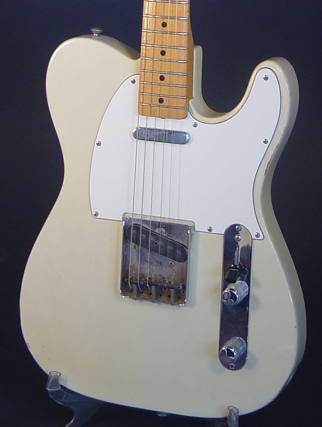

He SCORES
Well Good News and some bad news.
It's a 1966 Tele
It looks like someone tried to refinish a Blond body. It does look like the neck and the body belong together based on the old paint residue inside the neck pocket.
Now the bad news is some cretin butchered the neck pocket when they added the humbucker. I'm pretty sure this is a hanging offense here in Texas, at least it should be.
The control plate is really a mess.
I think the body was stripped completely and then sanded with coarse sand paper and a wipe on or spray on finish was applied. The electrical mastery on this guitar matches the woodworking skills.
So. If this was your guitar, what approach would you take to make it a player?
BTW, I do want to fix it up and keep it. It has a ton of redeeming features.

The tuners seem a bit odd. From the back it appears all are double-line Klusons which a '66 should have but only two are split shaft.
What do you mean "butchered the neck pocket"? I don't see neck pocket damage. Here's my neck pocket showing similar paint stick shadow.
I'm sure I'm not the only one wondering what you paid for this pawn shop find.
If you plan to restore it, it looks like you have enough to get a replacement decal from Fender if you're willing to jump through the hoops. I got a replacement decal for a '60 Strat once.

The brass saddles look exactly the same as the brass saddles Mighty Mite made in 1980. Here they are on a custom built guitar me and my dad did back then.
I meant to say the butchered Neck "Pickup" route.
I've gotten a little further in and Yes the bridge pickup with the large poles (Strat? Tele neck?) was "glued" to a copper three hole base. The pickup measured 5.53 on my ohm meter assuming you can accurately measure them while they are still soldered to the pots.
I've purposely avoided saying what I paid for the Tele because, well... pick a reason that suits you.
Depending on your perspective, I either paid too much or too little. I’m not sure why knowing would change anyone’s perspective. Just to put the question to rest, let’s just say I paid the equivalent of about three full tanks of gas for my Minivan.
I would encourage you to keep looking out there because there are still some hidden gems waiting to be uncovered and I think the high gas prices are going to flush some of them out of hiding.
I also think there is point in everyone’s life where the material possessions don’t mean as much to the family. Many people who are my age saw a Brand new 1964 Mustang or a 1963 Corvette Split Window Coupe in the dealer when they were kids, may have gone out and bought one when they were grown up and their kids were through college.
However, their kids are interested in a rice-rocket or a new SUV. The kids, at least my kids have no idea what my stuff is worth and I’m sure when they have my Estate sale there are going to be some bargains because I’m the only one who knows what I paid for them or has studied the supposed value.
Sounds to me like you got a great deal. My reason for wondering was to know whether good deals are still out there if you know what to look for.
I just noticed the doweled template holes on the back. That's a good thing to look for when looking at what might be an old Fender.

Personally, I would restore this baby to its original 1966 glory. Gut all the aftermarket stuff, redu the neck route, and completely refinish it.

That's what I would do. Restoring this one would be a piece of cake compared to what BAW4742 has done to restore his.

i would get a better bridge pickup, and leave the rest as is.

While I am at it, Please educate me folks: I can't help but notice the fret board is hardly a slab-o-rosewood. It look like a heavy veneer almost. What is the pattern for this in Fender across the years?
I'd guess this may well be a by product of refret(s) on this particular neck, the frets are hardly original type for that I am guessing. And the fretboard being thinner on the treble side lead me to think fret job, or jobs given the age. ;)
