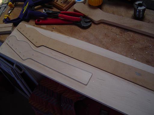

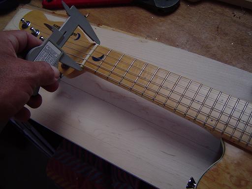

i was contacted to build a couple of mando necks for bucko and getbent. i haven't done one in about 10 years, so i figured i'd do another one for myself as well.
checking some measurements for layout from a previous instrument:
with the blank i have, i can get 2 full size, and 3 mando necks:

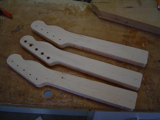

here are the rough cut necks:
the center one is mine. it is drilled for grover mini's. i don't know what bucko is using for tuners, so i will just leave him pilot holes. i will cut the fretboards, and slot them tonight.

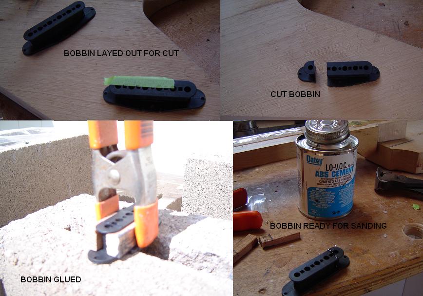

the pickups;
these necks are 5 string. the tuning will be (from low) C G D A E. they will need a 5 pole piece pup. i used to use a 6 string blade and center it, but now that i make my own pickups i modify the bobbins for 5 string:
where the wires solder up won't be centered now, but it doesn't matter, because it will be under the pickguard.

How are those five strings tuned? What string gauges?
What's going on for the fretboards? What's the scale?

"these necks are 5 string. the tuning will be (from low) C G D A E."
string gauges? Hmmm...haven't the foggiest. Whatever works I guess. Probably just the top 5 strings of a light set.
Scale length? Now how would I know that?
They'll have maple boards.

the scale is 13 7/8". for the string gauges 10's are used without the one for the G.

to exact answer your question: C .46, G .36, D .26, A .13, E .10

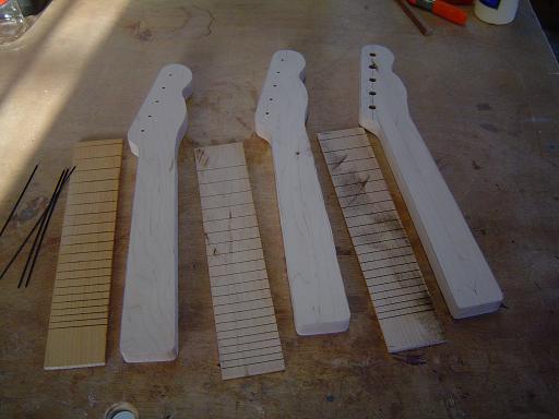

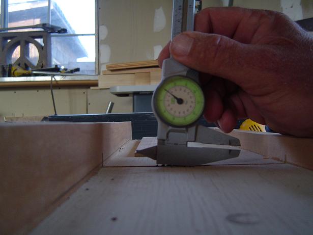

setting up the fret slot depth:
slotting the fretboard. i like taping the rule right on the back. this way tends to be more accurate then laying out then slotting:
the fretboards slotted, ready for inlay, profiling, and radiusing:

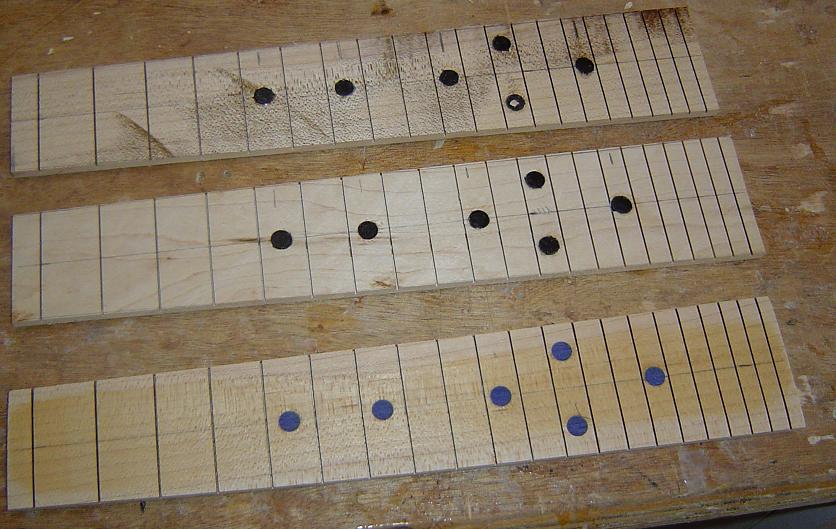

here's the inlayed fretboards for the mandos a.k.a "the three amigos"....
