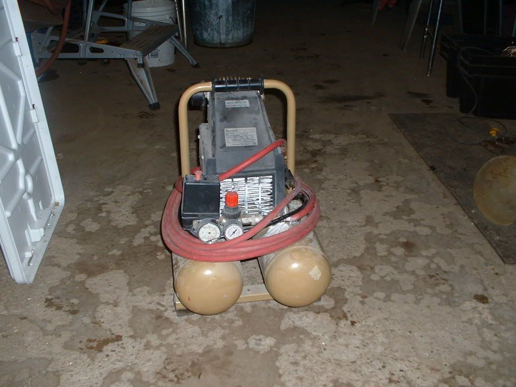

I bought this 10 gallon unit from Lowes. I had to get this one to meet the minimum requirements (or suggested) on my spray gun. I really like this compressor. It rarely kicks on while I'm spraying. It's $200 so it's just a little more than the pancakes.
Here's my spray gun...also from Lowe's.
