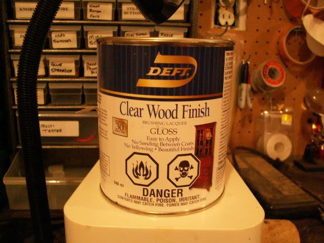

BTW, I tried some of that clear gloss Deft brushing lacquer over sealed ash and over ash with several coats of nitro, in hopes it'd build quickly in the pores. It doesn't level well at all. Even in controlled conditions it took a skin super fast and seemingly did not build in the pores at all. Doesn't smell like nitro but instead like butyl rubber. Wassup with this? You bet I took it back.
Is this what you are talking about?
I ordered in nitro and my wife picked it up for me.Is it crap?
Could a guy thin it and spray it?

Yup, that's it.
Digging into the details, they say you cannot thin the product nor spray it.
I'm glad I returned it, very glad. The spray costs a bit but is worth the money.
Maybe I wasn't meant to be a chemical engineer, but I am pretty sure this was reformulated, it really never caught on again once that was done, and that is why Deft is working hard to get that water borne stuff promoted on the website into our hands. Even the spray Deft I felt sanded off in a peculiar fashion the other day when I decided to sand it back down to wood after a month in 75 degree climate control, came off in little clumps almost like latex (which it definitely is not ). That 2 piece ash Warmoth body has seen an utter transformation, as it now has a very uniform, very flattering tint coat of Behlen Jet Spray nitro Mahogany sandwiched between more coats of Deft clear gloss spray that you can count. The spraying conditions are simply superb here in New Orleans, humidity still falling at 10:00 P.M., and I'm making full use.
I still like Deft sanding sealer, just left the darned can in Florida.
