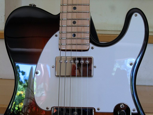

This is my G&L ASAT Bluesboy:
As you can see, there's a gap between pickguard and neck. The story is, the former owner removed the neck and replaced it with a Fender neck, probably because it was too fat and it really is the fatest neck I've ever touched on a guitar. He had to nag out a little bit from the pickguard, because of the overlapping fingerboard the Fender neck had.
I've got the neck then on ebay for about 60 €, shipping included, but without the tuning machines. The neck didn't fit to the guitar, I bought it for, so I did nothing with it. Month later, I found the rest of that guitar on ebay, same seller. I've got it for about 250 €, 'cause it was pretty worthless for the rest of the world. The seller obviously wasn't happy with the Fender neck solution and made the mistake to put everything instantly away, instead of keeping it for restore, so he lost at least about 1000 € on that guitar.
Uhm, what I'm trying to say: If everything fails, I'll buy the parts for low.
