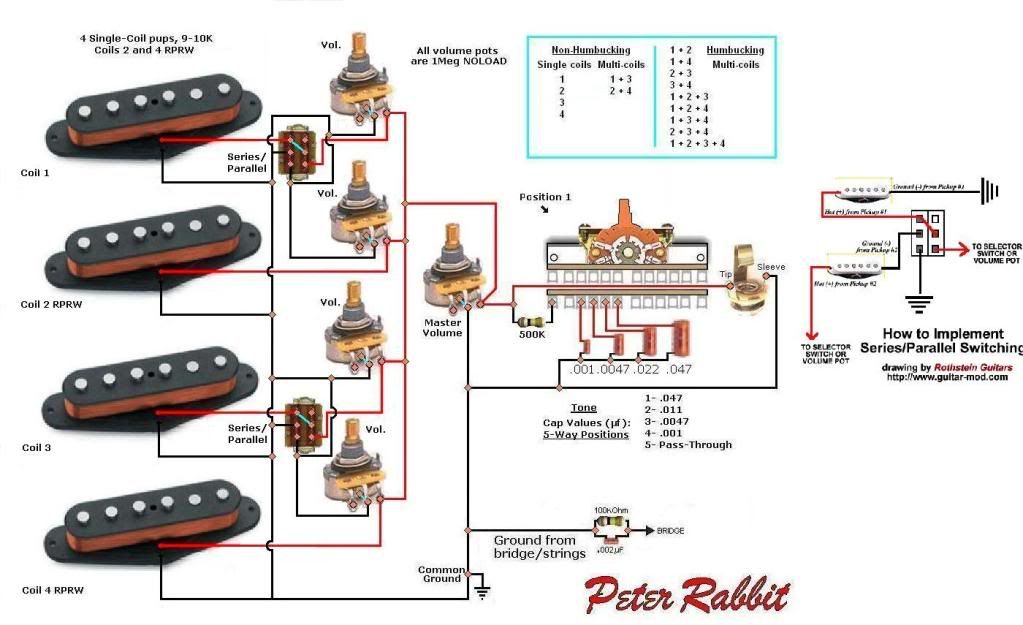

Howdy gang!
Got a new one to try:
I've been noodling around trying to find a way to access the full range of switching/mixing for all the coils in either a pair of humbuckers or some number of single coils. Many of you have seen the results - it's not a pretty sight.
So, maybe this will help me to get a more useful set-up. Considering the number of HB vs non-HB combos there are, it looks very good to me! (Unless, of course, for some reason that I don't see, I can't do this.)
I do need HELP wiring the superswitch to act as a 5-way tone control. - I don't understand superswitch wiring yet.
Also, I've been looking at the possibilities of a single toggle that will put ALL pups into Series or Parallel at once, while retaining thier individuality elsewise. Maybe, maybe not.
Also also, can anyone tell me how to insert an avatar, Please!
Thanks guys.

Well Wally, thanks, I got the avatar up - great!
The help I need is in wiring the 5-way switch to accomodate the capacitors, turning the 5-way into a tone pot with a bypass and 4 tone positions - values yet to be determined. Gotta try 'em and see.
In terms of the number of combinations one can get, the formula is [2 to the power of N (number of coils) less 1 - all coils off)], so for 4 coils the number is 15. And, for 5 coils - 31 combos, 6 coils 63, etc.
Of course, these don't factor in separate volume controls for each coil, which makes the combos infinite in number.
Also, note that I am going to try using 1 Meg no-load pots for all 5 volume pots, so that when on full, the signal has a true pass-through.

Old November 11th, 2009, 06:42 AM   #13 (permalink)
Location: France
Age: 30
Posts: 28
There it is.
As you can see, a superswitch is overkill for that application : only one pole is needed.
With the resistor value you chose, it will act like a tone control always on full (i.e. brightest), so you might not feel a lot of difference between the settings. Be prepared to tweak this resistor value, from 500k downto zero.
jlerhun is offline   Reply With Quote

Hey there, everybody!
jlerhun: With that diagram, you have just saved my sanity - thank you, thank you, thank you! You make it look so simple!
Two more questions, though:
1- which switch would you recommend? (the price difference between a 2 wafer switch and a single wafer one is about a buck, do you know of another that would work better? And, please, not a rotary switch - I'm REALLY not up on that wiring!)
2- and which cap values? I received from Borge (thanks again!) a formula for determining the relationship between the pot's value and the cap's:
but as you can see, I dont know what the symbols c, C, & R stand for, if you know, or can figure it out, please let me know - this is a bit beyond me right now. His recommendation is to first solve for Frequency (Hz) using existing values, then solve the right side of the equation using the previous calculation (Hz) plus the new pot value.
Isn't this fun?
You're welcome !
A SuperSwitch IS a 5-way, 4-pole rotary switch. Lying on its side.
For your application, i would go for a 1P6T or 1P12T rotary switch. A round hole is easier to drill than a slot ! As i said before, you could use a standard strat switch if you don't mind the settings being in a "wrong" order by adding capacitances in positions 2 and 4.
That one is another superswitch : http://www.thomann.de/fr/goeldo_eyb_schalter.htm
and this one too : http://forum.ibanez.com/Default.aspx?g=posts&t=73848
There are also variable capacitors (yes, continuous variation !) but i doubt a suitable value range will fit in a solidbody guitar : http://upload.wikimedia.org/wikipedi..._Capacitor.jpg
  • fc is a single symbol, the c is small and low : it means "cutoff frequency", the frequency in Hertz at which the filter cuts half of the signal amplitude (i.e. -3dB)
  • C is the value of the capacitor, in Farad
  • R is the value of the resistor, in Ohm
There's no comma between R and C, it's a multiplication. Let's take an example :
In my SG, i've got a tone pot of 500k, with a tone cap of 22nF. The cutoff frequency when the tone pot is rolled off will be 1/(2 x 3.1416 x 500,000 Ohm x 0.000,000,022 Farad) = 14.5 Hz, not taking into account the rest of the circuit (resonnance frequency of the pickup, volume pot, cable capacitance, amplifier input).
Here is a quick R-C filter calculator, implementing that formula : http://www.muzique.com/schem/filter.htm

First, Thanks again and again for this help. The explanation of the symbols in the formula is a HUGE help. As you suspected, since I'm using 1meg no-load pots, the capacitance will have to vary from the usual suspects: .047, .022, etc.
You have mentioned that "With the resistor value you chose, it will act like a tone control always on full (i.e. brightest), so you might not feel a lot of difference between the settings. Be prepared to tweak this resistor value, from 500k downto zero." What do you think about the idea of combining this cap/switch with a variable resistor rather than a fixed one? And then, of course, what value combinations will sound good?
That variable capacitor from Wikimedia does look a little large, but since this is a custom build - cutting and routing my own body - I can have any depth or thickness I want. So, maybe a variable resistor and a variable capacitor instead of the superswitch? Sheesh - too many variables (bad pun intended)
BTW, I did know that 3-way, 5-way, etc. switches and rotaries were brothers under the skin, I don't understand the wiring logic of either.
Now that thats nearly sorted, I'm gonna try to add some Ser/Par DPDTs - using the Rothstein Diagram on the left:
What do you think? And if I wanted to add a third DPDT for Ser/Par, where might I put it - between coils 2 & 3, or after the first two switches as a Master? Or both with 2 DPDTs???
Ahh, jlerhun, tu parle Francais, n'est pas?
Bien sûr, je suis français !
I never went to Canada (i'd like to), and i currently live near Paris.
I suggest you wire a temporary variable resistor, to find the the value that sounds best to you. That will act just like a classic tone control. If the value is different for each position, no problem ! You can use a different resistor for each cap, just wire it in series with the cap. You will then have five preset treble cut settings (one of them being bypass/no load/full twang).
Yes indeed, too many variables. As you can see in the formula, R and C appear at the same place, and could be swapped (multiplication allows that). It means that if you want to change the cutoff frequency of the filter, you only need to change one of them. Guitar makers chose a long time ago to vary the R (using a pot) and keep C fixed, because it's less bulky and probably cheaper than using a variable capacitor and a fixed resistor. Varying both at the same time is not very useful.
Just look at them closely. Do you see that small crescent-shaped metal tab that moves when you rotate that shaft or lever ? It's always in contact with one lug (hence named "common"), and makes contact with one of the other nearby lugs, one at a time. All these switches do the same thing, with one or several metal tabs (aka poles), and a variable number of switched lugs (aka throws).
A standard Telecaster switch is a 2-poles, 3-throws switch, 2P3T for short. A Superswitch or a PRS rotary switch are 4P5T. A push-pull pot is 2P2T, or DPDT. The only subtlety is the Strat switch : it has 5 positions, but only 3 throws ! The in-between positions actually connect two adjacent lugs to the common lug, which easily makes parallel connections.
You'll have to lift the ground of one coil of each pair to get series wiring : look closely at the Rothstein Diagram, the upper pickup has its black wire to ground, whereas the lower pickup has its black wire to the switch. It goes to ground in parallel mode, but it goes to the red wire of the other pickup in series mode. All the black wires are tied to gound in you latest diagram, defeating the purpose of the switches.
I would use a volume for each pickup, then connect each pair either in series or parallel with a switch, then connect both pairs with a third ser/par switch. After that, master volume and master tone (5-way).
