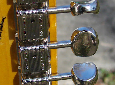

Age: 38
Posts: 120
Originally Posted by Ringo View Post
http://store.guitarfetish.com/wiklstnitusi.html
I asked about the Wilkinson vintage style tuners a while back, they look a bit nicer than the cheaper ones that GFS sells, anyone tried them?
I've used them twice now and really liked them. Here's a closeup.
