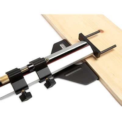

To make this a little easier and less nerve-racking, you can first create a block that you can place into the neck pocket that will let you guide the drill bit along it to ensure the proper angle. Just cut the correct angle in a block of wood, then cut that to fit the neck pocket. It doesn't have to be a perfect fit.
What's the correct angle?
Let's say the control cavity is 1.5" deep. If you want that hole at least .25" above the bottom, then it ends up being 1.25" down from the top of the body. Since you are starting the hole at the bottom of the neck pocket, that's 5/8" down from the top of the body. So the total drop from the start of the hole to the finish is 5/8", or .625". The distance is roughly 5.5 inches laterally. So using those two numbers, we know that the angle you need is 6.48°, or let's just say 6.5°. So you need a wedge cut at 6.5° that you can cut easily on a table saw or bandsaw. Insert the block into the neck pocket and let the drill bit ride along it and you will drill at the correct angle.
Before you start, draw another line on the body to indicate the exact direction you want the bit to travel, and follow it when you drill. Put a piece of tape on the drill bit to indicate the depth so you don't go too far and end up with a nice hole in the body. That length should be just a little more than 5.5".
Or you could just eyeball the whole operation.
Btw, if you cut a humbucker cavity for the neck pickup, you can drill the hole right from that cavity.

As you can tell from the photo of the pine body I cut, I use a Forstner bit to cut a notch between the neck pocket and the neck pickup cavity. I do this to allow truss rod adjustment without removing the vintage necks that I use, but it also allows you to drill the wiring channel much more easily.
You just angle the bit through the neck pocket, into the neck pickup cavity and on through to the control cavity. I still almost hit bottom!

Tom's guide block with a hole in it is a good idea. In his book on guitar building, Melvyn Hiscock uses something similar to drill holes from the heel and headstock into the truss rod channel. Here's my jig patterned after the one in his book. The guide block is hard maple. You wouldn't need anything this elaborate for drilling the body holes.
