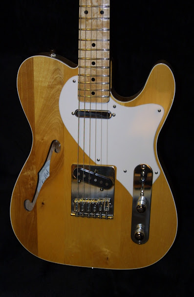

Here's a little back story. We got new neighbors, as it turns out I work with one of them. Anyway, they are completely re-modeling the house, ripping it out to the studs. In the process they tore out a whole bunch of maple flooring, you know the solid maple pre-finished type 3/4 x 2 1/2. So I harvested a bunch from the scrap pile and put it in the garage, de-nailed it and set it aside. Then of course what do we do around here with a pile of wood? Make it into a guitar of course. So I set out to make a guitar for our neighbor.
I didn't do a build thread on this one but here is a little description of how it was put together: Since it is maple I didn't want it to get too heavy so Thinline. I ran a whole bunch through the planer to get the backs flat and the finish off the tops. Cut off the tongues and grooves on the table saw. For the neck I laminated 4 pieces together for the main part of the neck and a couple "ears" at the headstock, planed down one piece that had some great birdseye for a fingerboard. For the main part of the body I basically made a butcher block that I shaped into a body and cut out the chambers. The top and back I planed some stock down to 1/4" and edge glued them. Opted for double bound and a small thinline pickguard with regular control plate.
For the plastic I discovered a couple sheets of white abs (I think) in the shed that the Mrs. had salvaged from her old job before they threw it away. I took a piece to work and set the shear at .250 and cut enough binding strips to last a long time.
Alright enough with the blah, blah right on to the pics:
Ok, after looking at the pictures, I clearly need to get a shot showing the binding.

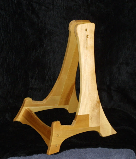

So I can't just give a guitar with nowhere to put it. So I took some more of the flooring and made the stand too.

First time I've done double binding, I'm always trying to add something new to each build. I was pretty happy with the color, it was amber shellack for color then lacquer, simple and sweet.

Yeah, they seem to ring forever. I use a maple core on some of my other builds cause I love the way it sounds. I could never imagine a solid maple guitar because it would get pretty heavy, that's why I opted for thinline, ended up about 7 and a half pounds.

Here you can see the binding better and the butcher block nature of the core.

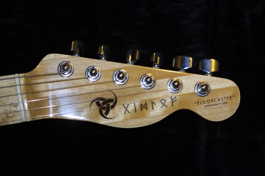

Here's the fingerboard, I found this piece of birdseye in the pile and picked the best section of it.

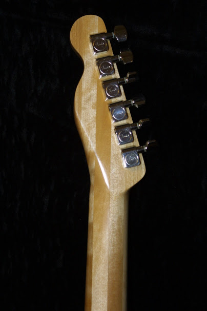

And here you can see the laminated neck.
