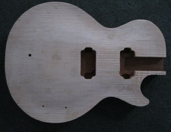

Back when I made my first batch of LP bodies...I actually spent 100 dollars on a super curly billet of maple.... It was gorgeous and is still here waiting to be used...I'd never be that foolish with my own money again, as that is a lot of expensive sawdust and chips...
This one was a pretty nice top.
The router dropped down accidently and bored a hole in the wrong spot. I also had a glitch around the neck pickup, but that would be covered up.
I was going to drill a matching hole, hoping to salvage it with a pearl dot or piece of ebony, a jewel, or even a Bigsby....it didn't happen.... That body sits here in the department of bad parts.
these days, I'm starting to prefer less curl and weight. I should probably retop it and get some use out of the mahogany.
Rather than trash the top to re-top it, have you considered just filling the hole and gold-topping it.? Hate to see you waste all that carve time. . .
--Rick
