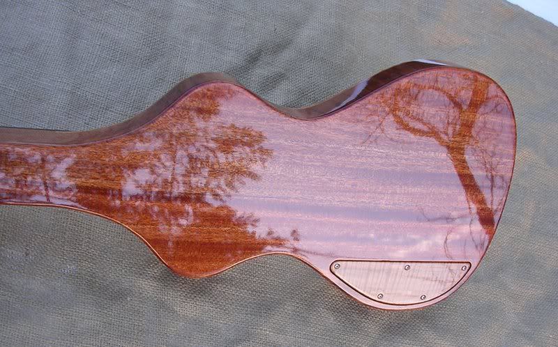

When I'm going for a flat and shiny mirror finish I generally lightly wet sand every 3 - 4 or so coats as I'm in the building the film phase. I find that 1000 grit and a few drops of mineral spirits works well for me. Once you get within the last coat or two, you can move up to 1500 - 2000 before the last glaze coat. Being that you have basically done all the leveling as you go, if you want to polish it out you can go strait to the fine polish when cured. Sand with the grain, and let the Tru Oil cure about a week before you polish.
Wow - that's a really beautiful instrument!
That is only Tru Oil? Wow, what a fantastic finish. Is your "glaze" coat thinned at all or straight from the bottle. And how are you polishing. If a finish like that is possible with Tru Oil I would be very willing to try and become a convert.

Be warned: Tom Pettingill is a master at gloss Tru-Oil finishes!
Tru-Oil is not well-suited to wet sanding because the layers don't
melt together as they do with lacquer. I guess that's why Tom
sands with 1000 grit -- so that he doesn't sand through the top
level and get "boundary lines".

But Tru Oil, if you do it like Tom laid out, is very well suited to wet sanding!
Here's a neck I did in Tru Oil...wet sanded then buffed. Not as smooth as Tom's finish, but you can see what you can do with a reasonable effort.

The only layer you cannot cut through is the top layer. As you note, cut through that and you will get witness lines that no amount of polishing will erase.
So, if you do level sand then always plan on one (or two) final coat(s) that you will only sand with the finest papers (think 2000 grit and above - if at all) or that you will only hit with compound and/or polish.
And, as always, proper surface preparation - level sanding, and level filling, make the finishing process much, much easier, adn the final results that much better.
