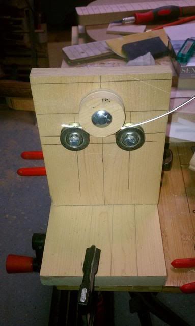

So I know there have been threads\builds for these before, but figured I'd throw mine in the ring with a new thread. I believe this is based on the Terry Downs version (not sure since that thread isn't active any more) but from what I can tell its using the same parts\idea, with a few modifications of my own after seeing a few other builds here and on another guitar building forum. Basically using 2 sliding door wheels for the bottom, and a few different sized washers for the top wheel.
So here it is:
I feed the fretwire in by hand, and have the top wheel locked so it doesn't rotate. The bottom two wheels do, and it slides through like butter. The reason I locked the top wheel is that I found there was a bit too much play in the washers, so it would either splay open and the wire would slip inside or they would become slightly offset enough to twist the wire. But after locking it tight, I have no problems with it and actually think having the top wheel so rigid helps keep the wire nice and straight.
A little bit of trial and error to get a perfect 12" radius, marked so that if I need to get a smaller radius, I can progressively work my way up, marking it along the way. Only wasted one 2ft length of wire before getting it where I needed.
Blew through the rest of my wire and got a nice consistent bend in a matter of seconds.
Cheers and thanks again to everyone who contributes the ideas that make it possible for people like me to tackle things from the simple to complicated! I'm pretty sure I owe a few people thanks personally for the idea's that led to my bender....(Terry, Jack Wells, Nick JD, etc)

Where is that radius gauge from? Looks cool, and cheap!
I do all my own mistakes.
whodatpat is offline   Reply With Quote
Old February 4th, 2013, 09:15 AM   #6 (permalink)
Join Date: Jan 2010
Location: Worldwide
Posts: 696
^ thats a Stewmac FPI. Here

As for that 2 ft. wasted piece you should be able to fix that easily by re-bending after an adjustment. You could also double-nut your washer roller to the point where it spins freely with little to no play.

Here's mine , T.Downs design , works great
Very nice! Had considered going the wood route but would have had to buy a hole saw. So luckily I found the washer threads, ended up saving me a few bucks.
Another good design. Thanks for sharing also.
Thanks Scrapperz, can't take too much credit for the design, just the execution with some slight mods. But the section of wire is gone for good I'm afraid, ended up twisted and became my sacrificial guini pig. Well worth it though.

Yup from Stewmac, with the fret press set to use with my drill press. Very handy!

But the beauty of this is that it literally took me about 10 minutes to assemble. Maybe another 15 for adjustments but overall super easy.
