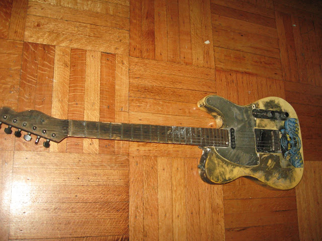

My Tele lived through a house fire, and all I did to the neck was clean the soot off and have the frets crowned (which needed doing anyway).
If anything, I like the neck more now.
Nice look.
The OP could do the butane torch charing to a pine tele body like this body from another thread.
