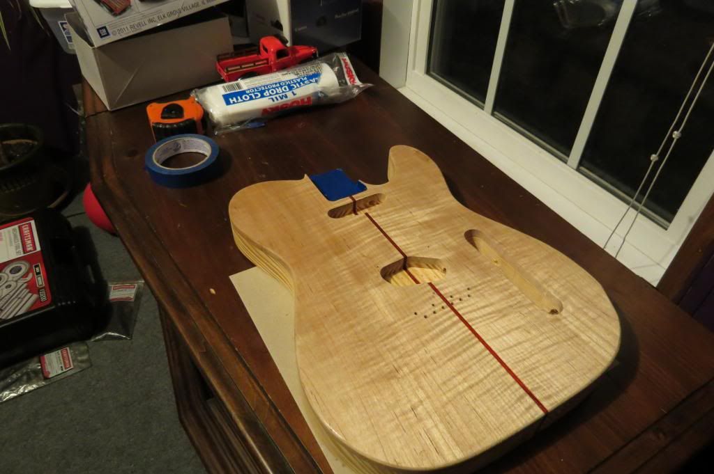

cabronita build
I received my warmoth cabronita body today and did the final touch ups on my neck. I still have not decided upon a color for the finish. I am debating between reranch crown royal purple and Mazda's Copper Red Mica. Either way this is how it is shaping up.

Im in no hurry. I have not used automotive paints yet for a body but I am loving the idea of the copper red mica cabronita. Its not one you will see many of. Thank you for the tips as Ill be sure to follow them. this will be my second finish on a guitar. I finished one body before using shellac and minwax lacquer. It took well over two months. It came out half way decent for my first time trying. I like using zinsser's sand and sealer in particular. its very easy to work with and to sand. here's a picture of the body after the sand and sealer coats.
Here is a pic of the body once the final clear coat was on.

I was able to get the sealer coats on today. I have to say I really love the grain on this guitar. It makes me think I should go with a trans finish of some kind.

I was thinking mary kay might be good. I was also loving this autumn burst cabronita that I saw but Im not sure I could get the burst right. The purple is indeed nice I just feel its wrong to cover over such a nice grain. Thats one super nice Gretsch.

TruOil works great over dyes and stains, but i don't know how it would work over lacquer. i don't think it would be a good idea, because you could run into some finish compatibility problems and ruin a lot of hard work. Tru Oil is actually a varnish, and aside from linseed oil, tung oil and various plasticizers, it's got a bunch of other stuff in it too (at least as far as i can tell from the MSDS.) it would be great for the neck, but i wouldn't recommend it over lacquer...i just don't know what would happen.
i think a Mary Kaye blonde finish would look really nice (and it's one i'm considering for my Tele build.) just keep in mind that it's usually done over ash so you can see some grain, and doing it over alder hides virtually all of the grain. while your body's grain pops right now, a white blonde will hide most of it. it'll still look good, but the grain is subdued so much that it almost looks like an opaque white.

[QUOTE=Cat MacKinnon;4771013]TruOil works great over dyes and stains, but i don't know how it would work over lacquer. i don't think it would be a good idea, because you could run into some finish compatibility problems and ruin a lot of hard work. Tru Oil is actually a varnish, and aside from linseed oil, tung oil and various plasticizers, it's got a bunch of other stuff in it too (at least as far as i can tell from the MSDS.) it would be great for the neck, but i wouldn't recommend it over lacquer...i just don't know what would happen.
?? the tru oil is only on the neck and its not over lacquer its over shellac. If I were to use it as a final finish it wouldnt have been over lacquer just over the color paint. But even with that I dont know how it would turn out. Most tru oil is done straight to the wood.
its more than likely going to end up the mazda copper red mica or i may try my hand at an autumn burst.
