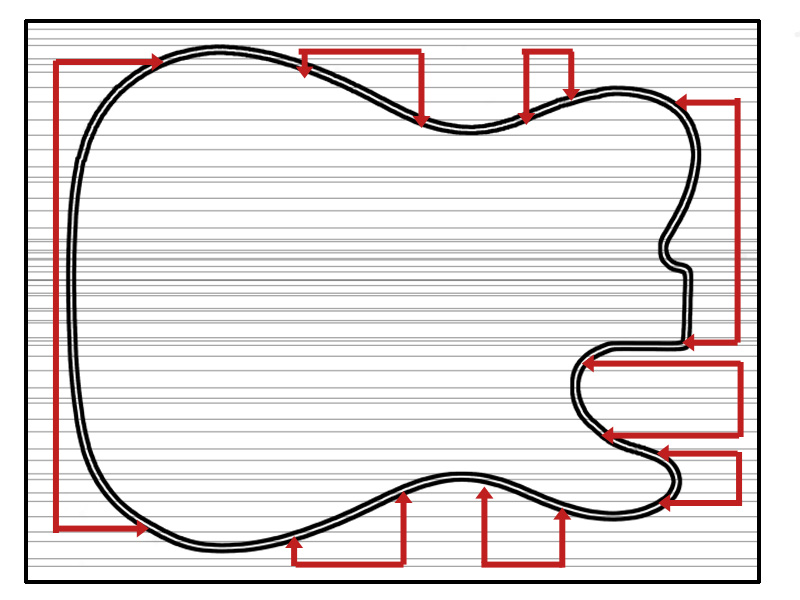

Hi Mark:
The more I think about it, the more I'm interested in what you did with that one. Making it with a hollow core would resolve the "weight issue" and allow me to use that really special wood for the entire body. I do have a question, if I may: could you have just as easily cut out the sides - vs. hand bending them? Or maybe I'm not understanding your comments right.
Anyway, that is a sweet looking (and great sounding) guitar! Thanks in advance for any assistance you can provide.
Will

Originally Posted by JustPlay View Post
Hi Mark:
Will
Hi Will.
Thanks for the kind comments.
The bent sides were part of the overall design. The core was made up of many strips of scrap maple. This meant that all of the glue joints needed to be covered. It also meant that there would be no end grain showing anywhere on the body. If you look closely at the photos, it's flame maple side grain all the way around...like an acoustic guitar.
If I had cut the sides to shape from a larger piece of maple, there would have been issues with short grain where the bends turn cross grain...it wouldn't have lasted thru the cutting much less the production process. Plus, it would have been a huge waste of resources.
You can see all the short grain..in red...that would be produced by cutting them to shape.
