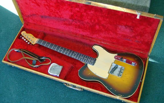

A '59 esquire custom passed through my hands & I loved the double bound look & fancied having a go. Here it is;It's actually a 3 colour 'burst but the red has faded to almost nothing & I prefer that look.
tone volume is offline   Reply With Quote
