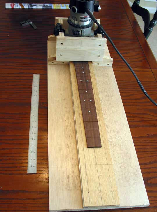

Hello all! I've decided to try my hand at building necks. I know there are multiple ways of doing it and a ton of different jigs. What are your favorite jigs to build necks?

Here's mine...we've been discussing it in another thread.

Incomplete Guitar Projects of America IGPA

ill post some of mine tomorrow. i use a box with straight and curved rails to slot truss rods. And i have another jig that has a pair of rails and a sled with a pair of radiused slats on it for radiusing.
got a couple jigs for gibson style necks too. one for cutting the peghead angle, and one for tapering the back of the neck.

Is this the one you built? If so do you have a better mechanical drawing?

No, that is somebody's variation of it. I had this posted over on Mimf a decade or so ago, and a guy named Todd Stock took the concept and built it was a couple minor mods. The link is in post number 2 up above in this thread.

That link is OLF and that is where the tutorial and sketch that Todd made is to be found. You should be able to access it without joining. The Mimf one is in the mimf archive. No sketches there, maybe just a picture if I recall.
An alternative is the jig posted by Scatter Lee.
http://www.tdpri.com/forum/tele-home...ml#post1651970
What I like about this design is that the radius is put on
the router sled only. In contrast, the design above
requires matching curves on the sled and on the base.
If nothing else, this seems to make construction a bit
trickier.
trickier.
The matching curves occur by having your pivot point the distance of the diameter of your router bit on the trammel jig. Two pivot holes 1/2" apart will produce mating curves if using a 1/2 radius bit to cut them out, so it isn't any real work to do that while you are doing the curves for the top section
Thanks for explaining that. Still, it seems that having two mating
curves means twice the chance of problems arising from little
problems in cutting (or routing) the curves.
Is there any advantage to having mated curves?
I tried to mimic the trunions on a bandsaw table. I think the rigidity is a plus and the inside and outside guides keep everything from shifting.
Note the early scatter jig... and then the later scatter jig.:-)
Here is where it all started.
http://www.tdpri.com/forum/tele-home...templates.html
