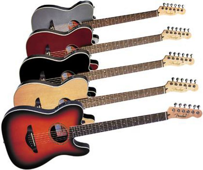

Do you mean something like the Telecoustic?
